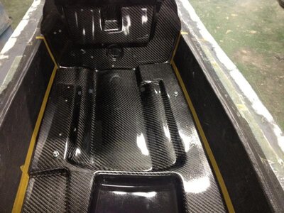

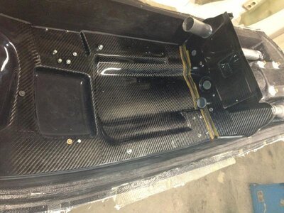

Sj i have to look for conditions but Trixstar molds are the molds were im building my hulls with at moment. Bottomdeck, b-pipechamber, inner visualcarbonparts in engineroom and handlepole i sell out of mold. Topdeck and outer hoodpart i have to grind with 400-600 wetpaper and spray clearcoat or paint because of 2 gelcoatfails in the mold. All molds are cleargelcoated to look at resinflow ininfusion.
Molds for infusion are:
Top/bottomdeck, upper/ lower handlepolepart, outer hood, 2inner visualcarbonparts in engineroom , adjustable footholds and rideplate.
Innerhood is handlayed and vacuumbagged
Handholds, pumpshoe, intakegrate, b-pipechamber......are handlayed
Orher option is to buy a hullkit unglued out of mold an you complette it an try to sell. Next hull kit comes with all molds without infusionmolds and next order you buy infused parts from me only and layup other parts by yourself. If 6kit soldyou get the infusionmold for free and pay workshop only( or before first hullkit???)

At moment i think the molds go to a canadian builder. Workshop is in april . We have changed the location of gastank and addited 2more batterielocations . Now you can build in Fp and PF with powerbox without any mods on your hullView attachment 209160
