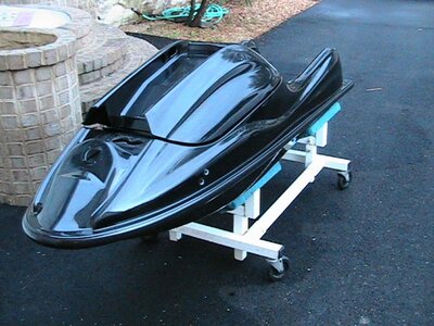

My empty Bullet Gen 1 hull with hood and mats weights 116# which they say is 70 or 80 pounds less than Stock Sxr. Hopen to have it done before wavedaze and I'll weight it complete and post it. John

Yes it has the carbon nose piece, It may of had the battery box and motor mounts and pump shoe in it.
Well you are gonna love it. I miss mine alot. I'm gonna guess that it is assembling very easy and the finish is one of the best you have seen? For the same price as other A/M hulls?

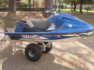

I have a Bullett Yam GP sitdown from back in the mid 90's and it still looks Great and the hull is like New. So I know Bullett hulls will last. John

Stop teasing me with pictures of the Bullett GP. I'd still love to drop an 1100 in that thing!
Chris,Sold the other one. This Blue one is the family crusier with a nice 760 ,pipe and single 47.Nice and Lite!!!
