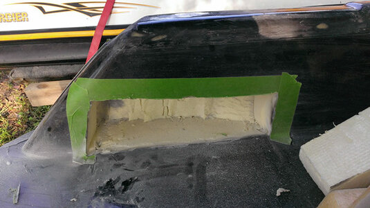

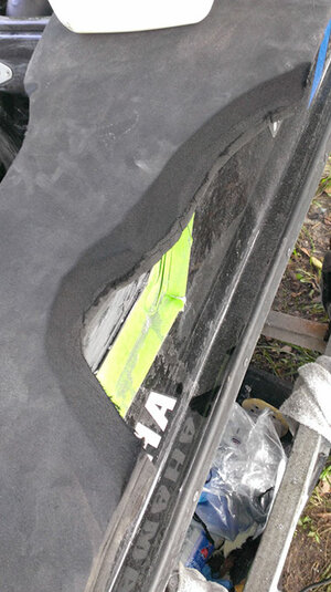

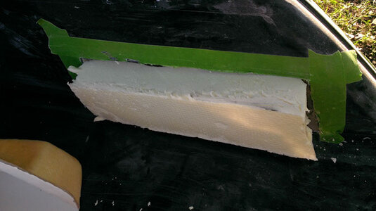

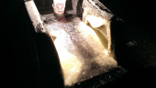

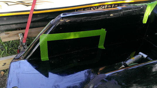

Yep, cut em up to add some more padding. Make sure you're using epoxy resin.
This is not something you want to rush either dude. Getting it done by tomorrow is gonna be tight.
Thanks. Great advice. I only use epoxy. Ya, the cure time will not be my friend. I am comfortable doing the work. I needed to get a solid plan of attack. It was my intent to seal the foam behind the gunnel with its own layer of glass to try to avoid water admission in case a foothold micro cracked.
