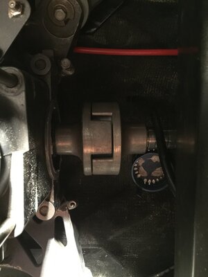

They powdercoated my couplers and now the rubber damper wont even fit in it lolView attachment 319805
They look like that. Do yourself a favor and ditch them immidiatly. Cast, cheap, really hard to judge alignment as they taper down. I swear mine aren't round I'm just waiting till my new motor is done and they will go directly in the garbage. I wouldn't even give them to a stranger at a freeride that was in a pinch LOL
