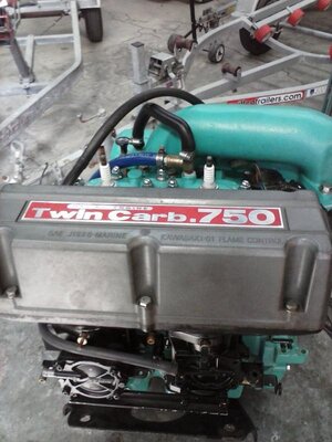

Alrighty, this is just a good old fashioned build thread. Basically, we (my Dad and I) are taking the motor, electrics, and pump, from this (best picture I have at the moment):

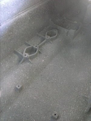

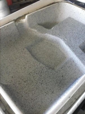

After giving it a wash we let it dry for a week and then painted the engine bay with some neat stuff.
Engine bay
The engine bay was originally an atrocious metallic gray colour and the paint was peeling everywhere. From memory, this is the crap that is sprayed in the wheel wells of cars. It provides a nice bumpy texture.

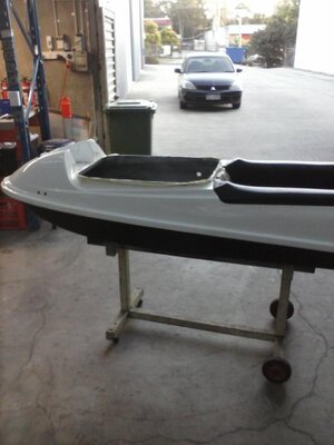

Chillin on the trolley. The paint job on this ski is pretty good.

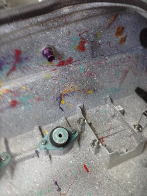

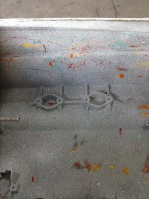

We used some paint and tools to fleck paint into the engine bay. It's pretty sweet but I'm not a big fan of the big splotches of paint. Luckily the engine will cover most of them. The left side is much nicer than the right.

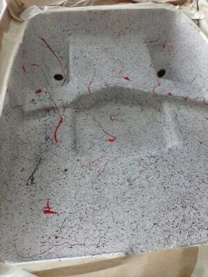

Oh lord jesus, the underside of the hood is just right. I love it. It was all clear coated afterwards, it took almost two rattle cans to coat it all.

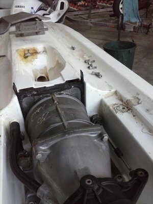

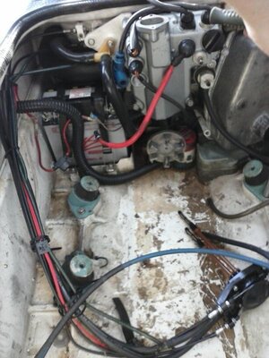

This is the DH engine bay. The waterbox has a small hole or leak in it apparently. The steering cable was run under it (apparently its not supposed to) and part of the sheath had been melted from the waterbox being so hot. Does anyone know if its normal for SXI's to run hot? When the DH was running the exhaust water was always very hot, the paint had been flaked off from where the pisser was. Anyway, the stuff on the battery terminals is not corrosion, its a grease that we put on a lot of bolts so that they are protected and easier to remove in the future. I went a little overboard on the battery terminals though.

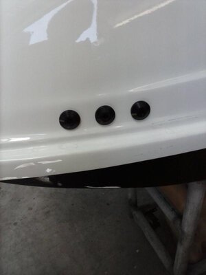

As you can see the underside of the DH is pretty banged up. When both of the hulls were empty we were moving them around and there was definitely water in the foam in the DH. There was a ~5kg difference in weight we estimated. The cover over the exhaust is from an Ultra 150/130. Its pretty bitchin. When I couldn't ride very well standing up for a long time I used to "go kart" (ride on your knees) for a long time, and the exhaust was hot hot hot, so I asked dad and we put this cover on it. It also sounds better too which is a plus.

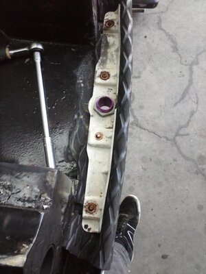

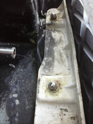

This is the bit that holds the mat to the hull in addition to the glue. Because we are ocean side (straya!) rust developes on a lot of things. We put some nice dome head nuts on it and spring washers, and the good old grease. It's the small things that count.

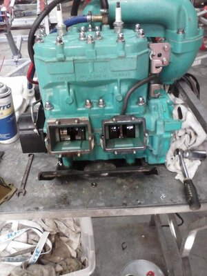

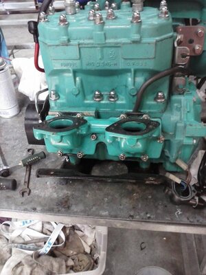

Just a regular 750 right? Nah mate. Dad says it was bored out etc ( I can't remember what he said specifically) and its now about 800cc. We were running a single carb to save on petrol, but its about the same economy either way, about 40-50 minutes of riding, not counting time to get back a re fuel (ocean side riding can be a bit freaky like that. Have to keep a track of time and take into account the time it takes to get back to port before you are running on fumes).

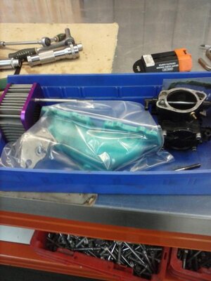

Bagged and tagged. Single carb, mani and filter/arrestor.
Dual manifold on

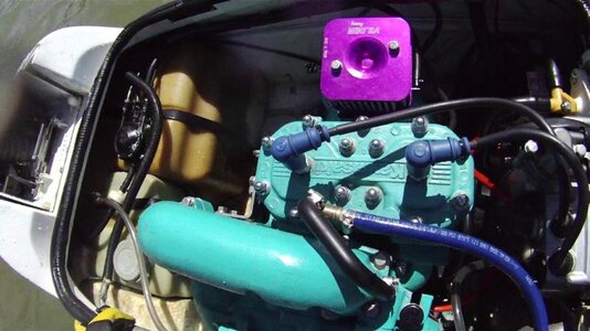

Carbs and airbox on. The engine only has ~20 hours on it. It's go good compression (~145-150 on both cylinders) and runs pretty great.
