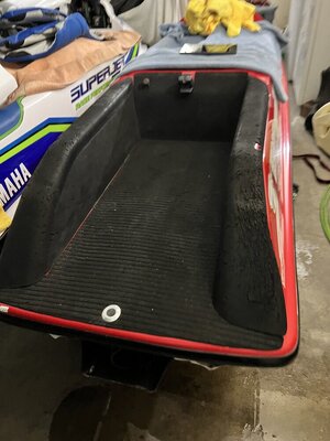

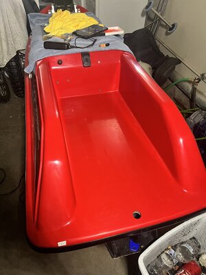

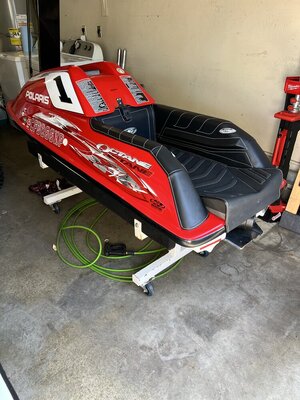

I finally got rid of the cat scratch og turf and got some Jettrim!

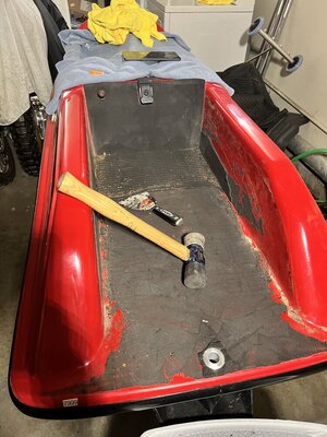

That Jet trim looks awesome on there! What did you use to get the tray so clean when you were removing the old turf?
Thanks, I am really happy with how it turned out.
As far as the cleaning of the old turf and glue it took a combination of brute force, multiple scrapers, and I used krud kutter paint cleaner as a chemical so when the glue got loose it wouldn’t stick back down. Oh yeah and a bunch of 805’s
