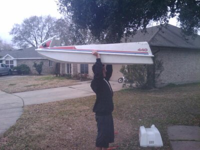

so i spent the most part of the day cleaning out my old 440 hull to be messed with.

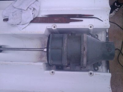

i pulled out my 144 pump as well, with the superjet driveshaft.

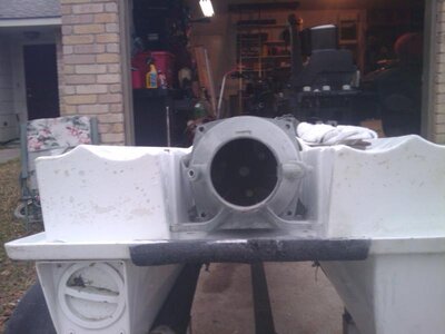

i mocked up the 144 with the pump cavity "as is" to get a basic idea of all that has to be changed. Im thinking im going to leave the pump sitting as far back as it is, to get more throw for steering. maybe move it slightly more forward. and im also thinking of raising the tray slightly to gain a little extra room for the ride plate to fit.
as for the sides of the pump area, im going to have to gain an extra inch at the least to make room for the steering cable and water inlets/outlets. the ride plate may have a slight dip in it and be lower than the rest of the ski but it wont be much of one to make that big of a difference. I dont plan on riding this ski in much of anything but surf, so i dont believe the change in height will make that big of a difference. the pump tunnel only needs to be widened slightly to line up with the 144 pump correctly as well.
so thats the plan as of right now. For those who think this is a waste of time, thats all good and dandy. ill be happy with my lightweight yamaha powered Js hull :woot:
who needs those lightweight hulls that people can hold over their heads? just get a Js!
