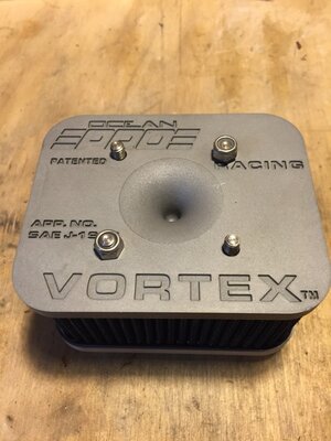

I just installed my "make it fit" WetJet Kraze pipe and a Westcoast head with 31cc domes. I'm going to throw on my new intake manifold, OceanPro Vortex F/A and 46mm carb next. So what jetting do you think for 4000' above sea level with my new modifications? Right now the carb has factory Wetjet Kraze jetting (117 low, 155high 1.5 needle). i was thinking about changing to the needle to 2.3 and set pop off at around 20lbs. Thanks for your help!!!

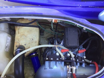

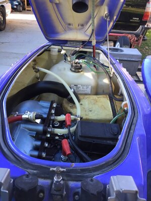

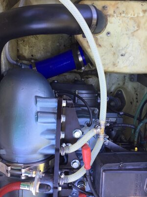

I finished up plumbing the cooling lines and fired it up. It definitely has more BRAP! Now all I need is to get my new carb on. Any thoughts on the jetting?

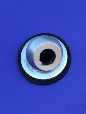

Do you think running a single screen would warrant going up in jetting the same amount as running an OceanPro Vortex? I know running a single screen would open up the flow of air. I also forgot to mention I removed the choke plate from my carb and am running a primer. Thanks again for your help!
Bishop CA

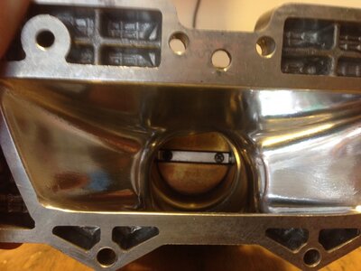

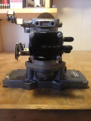

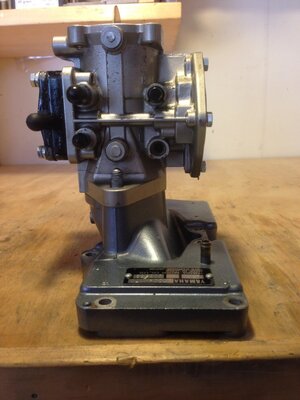

Here's my carb (choke plate had not been removed yet) and the stock intake manifold I modified to increase flow. I ported the manifold and reed plate to flow air seemlessly to the case. I know there are better manifolds out there but I wanted to improve the stock design. This is a budget "make it fit" kind of build!
