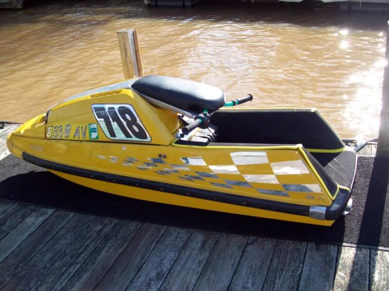

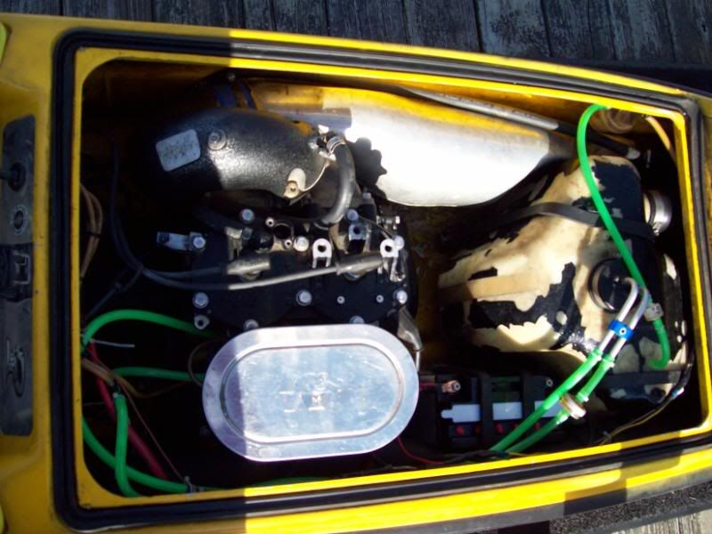

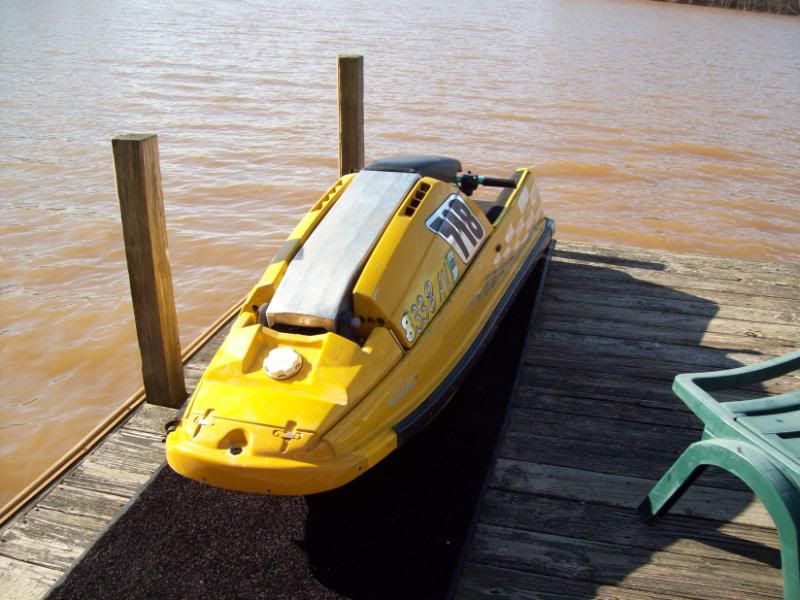

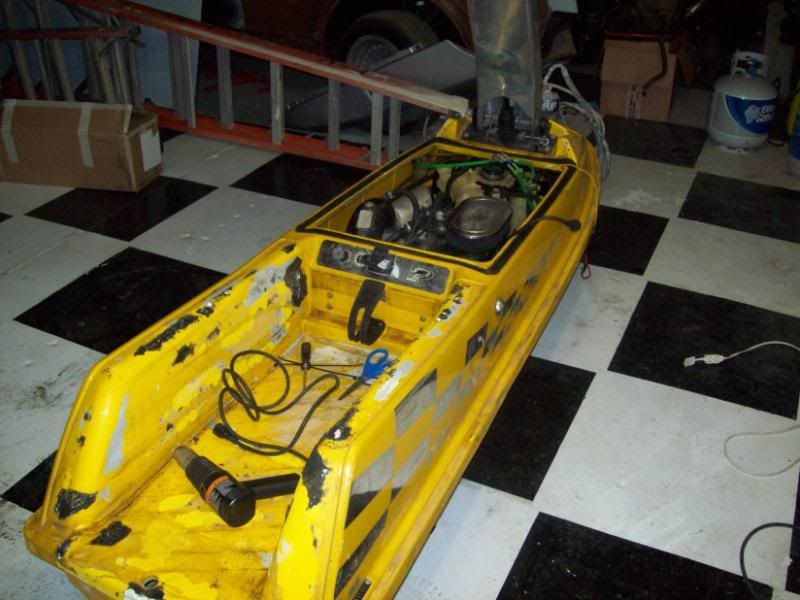

Alright I picked up my (new to me) 1990 Squarenose during the Christmas break. We've had a few 55-60 degree days here so I've had a chance to ride it, and it RIPS!!!! I was trying to build a ski a couple years ago, but had to sell my work in progress due to purchasing the little lake house we are in now, and having a BABY!!! (and some slight legal issues...:shhh:) It seems like this ski was setup for racing awhile back, I still have to totally go through it to see what is already been done to it. So anyway heres what I have and know for now...
1990 SN
701 engine w/ dual 38's
Factory B pipe into limted chamber
Aluminum handpole
Bilge pump w/ the waterproof switch attached to the start and stop switch
Solas impeller (not sure what pitch)
Extended ride plate (not sure what brand)
Intake grate (not sure what brand)
And a few other odds and ends..............

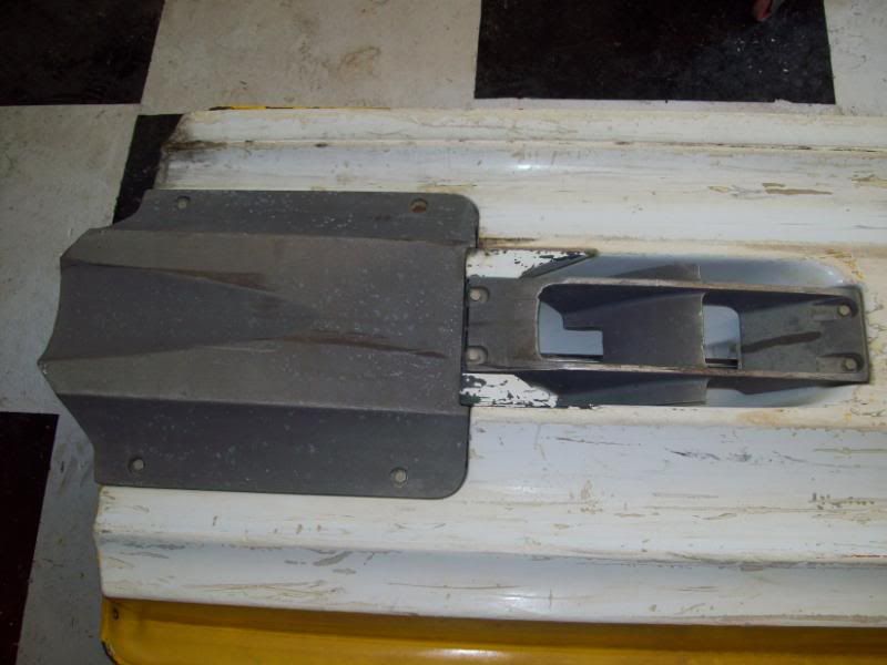

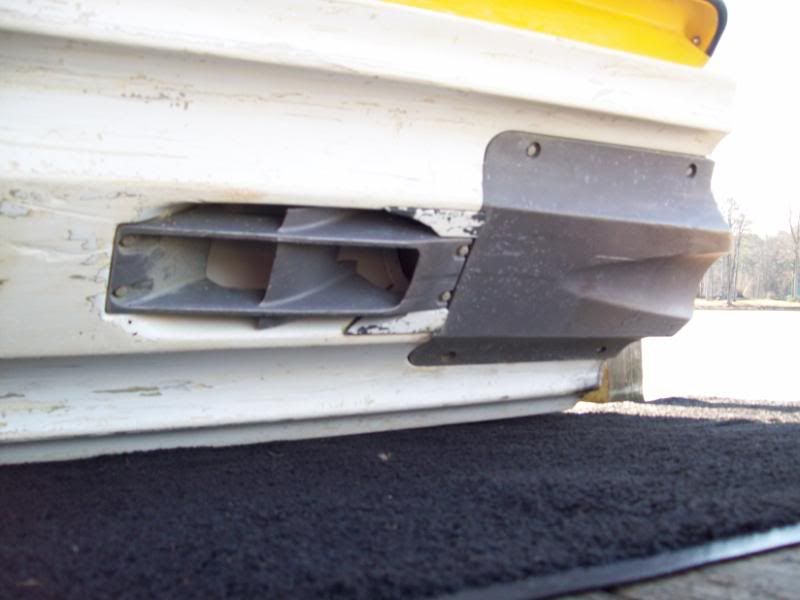

i run the same ride plate and intake grate combo and i really like it...
im pretty sure that grate led to the breaking of my stock pump shoe though.
its very agressive and hangs down very low compared to others.
my plate is even a square plate on my round too.
good luck with the ski... looks nice
Thanks! I really like it too. It sticks pretty well carvin around, and I can get the ass to break lose when I want. I think I'm going to keep that as is.

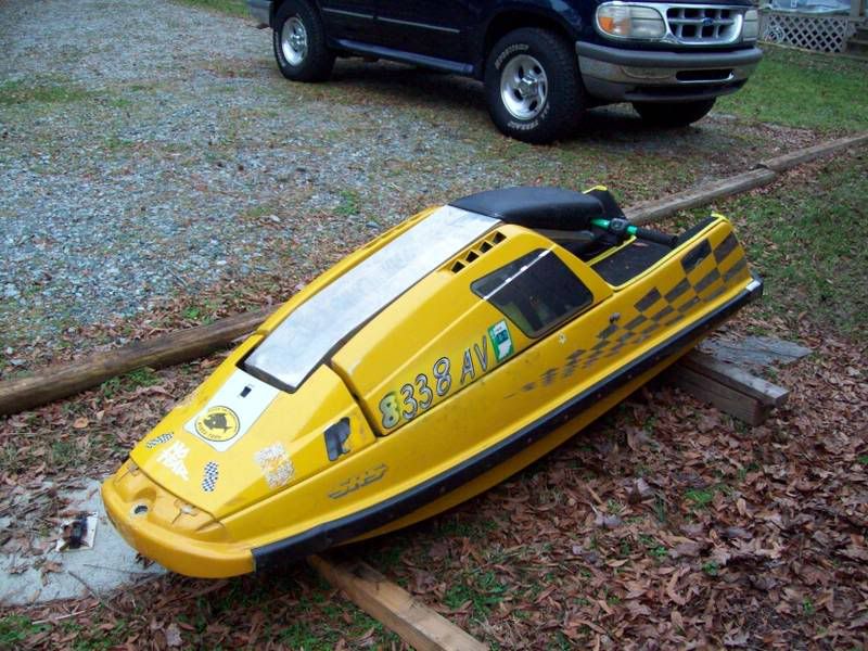

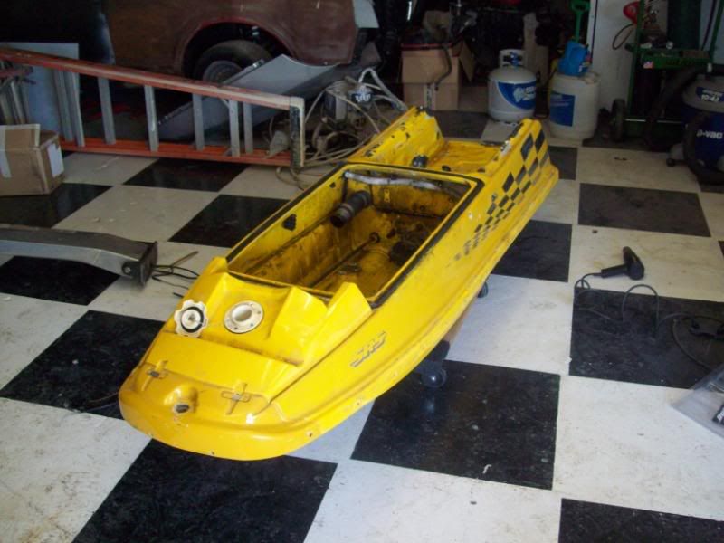

Well took a vaction day today to tear down.. So I got paid while tearing down my ski!!! ( I thought it was a fair deal) :Banane09:

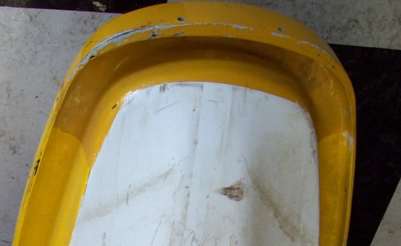

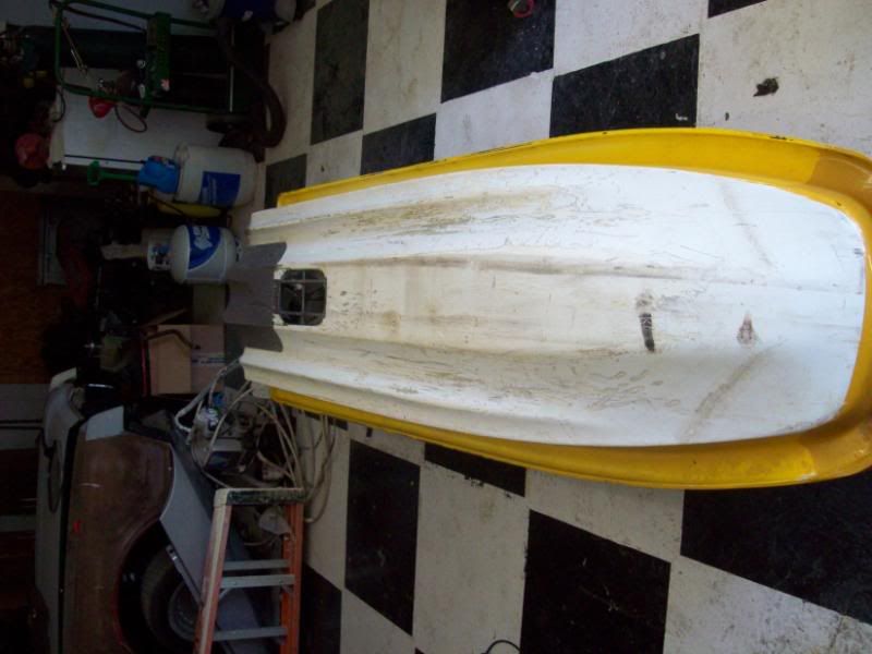

So anyway when I flipped it over I seen there's alot of scratch's and kinda deep gashes.. Should I just sand it down and fill w/ evercoat fiberglass filler, or spread some of the epoxy resin in and sand down??
Also noticed that someone built up the nose...

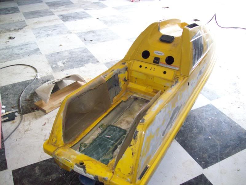

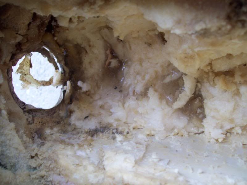

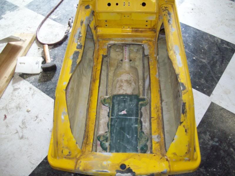

OH DEAR GOD is there a quicker way to defoam this tray...:banghead: Right now I'm using like a wire brush on the end of a drill and a shop vac as I go....Is this the fastest way?????? Sorry no pics left the camera at the house......

i found a couple prybars to be the fastest way to get the big chunks out...
for the last bits i used the wire brush on the drill. that will clean it up nicely in the hard to reach spots.
thanks I'll give that a shot on the other side... And get some more pics up this weekend..
Now I have the hood mod started, and the defoaming half done. The footholds should be here tommorow, so maybe I can get it defoamed then refoamed w/ the footholds in and ready to start sanding and glassing....

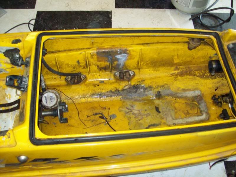

So everything that could leak was leaking in the tray of this thing:17:(exhaust hole in the back leaking the worst)
And I STILL have just a little more defoaming to do............

Dont true the bottom- makes the ski really squirrely.
I did it last winter and then let it rock on ramps during the summer
to roughen it back up!

So do you think I should just paint over the bottom and leave the scraps???
