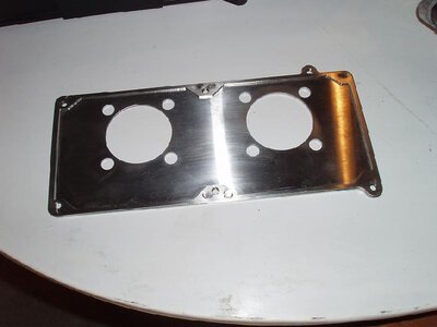

Who would want some thing like this that allows you to use the stock flame arrestor for a twin but have a high flowing base under it

it will will work with all manifolds i just adjust the spacing in the drawing
that one was a copy of the one i used to run on my 760 manifold with 44s

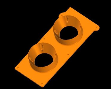

I did the same thing kind of. Guess I could just bolt the adapters down to the plate and carb.
Looks great Wax.

yes that what i have as well
it doesnt look as good as yours but its the same thing
However i think you should put the holes inthe middle as it moves the arrestor away for clearance on the engine

They are off to one side to move the arrestor closer to the hull away from the engine. I have a cad file on it that I used for the laser if you need it.
