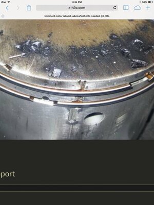

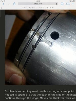

It's possible that those marks could be from detonation, but it looks a lot more like a piece of bearing cage let go and bounced around in the combustion area to me.
