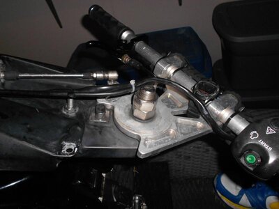

I was forced to cut my ride short last weekend when I snapped my UMI steering stud. I borrowed an idea from ScottS and got it repaired today. I chucked it up in the lathe and bored a 3/8" hole so it will accept a stainless bolt.
So simple, check it out...

I broke one too, drilled, tapped and put in a stainless steel longer stud. now I use two jam nuts on it...does not come loose now.

Great idea. You can also put a longer bolt in there and add an acorn nut to the top for a chin pad support if you don't already have one.

You can break them easier from too much play on tightness and too much shoulder workouts.
I use a split locknut and my system never has any play. I was riding along and all of a sudden I noticed it had some play. I was thinking, wierd, I will have to tighten it when I...SNAP!...get back to shore. :banghead:

I did the same to my wdk plate and when the stud pulled it all went at once. I was on the hood facing the back with quite a bit of weight on the bars. It was pretty funny to say the least.. at least for those watching lol. Scared the crap out of me! I went with a 3/4 inch stainless bolt and double nuts because of the huge hole left where the stud pulled out. The hole is actually a tad bigger so it aint perfect but it does the job. Cost me 15 bucks for the bolt (had to be ordered too) and had to buy a bag of 20 nuts for another 22 dollars, ugh...
