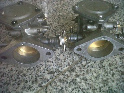

Here's a pic. BJ "44" on left "46" on right.
The bottoms are identical. So I either have a BJ 46 or a pair of aftermarket 44s.

doesnt art remove the venture? just smooth taper bore all the way? so does the "bj" have a full, partial, or no venturie?

Ya, BJ has no venturi at all. Comparing the two (that seem identical), you can see where the "aftermarket" machining is. Art basically machines out the venturi and presses in a manufactured annular discharge throat. These two carbs seem identical. I'm thinking I bought some 44mm carbs that were advertised as 46s. The price was great for 46s, but only good for 44s. I surely don't want to make this claim unless I'm sure of what carbs I actually have here in front of me.
