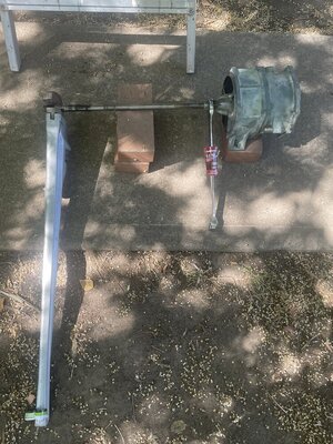

Are you turning it the right way? It's reverse thread.Hey guys, I have heated the driveshaft to red hot and then iced it.
I have also heated the oem aluminum impeller.
I have a 1 1/16" or 27mm open end wrench and put the spline end of the driveshaft in the shaft holder in a vise and I STILL CAN'T BREAK THE DRIVE SHAFT LOOSE !!!
I have a 36 inch pipe wrench. In addition to the open end wrench, I also have some adjustable Crescent wrenches which I can put side by side and slide a 3 foot section of mild steel 2" square tube over those wrench handles to really get some leverage on this thing.
But I can see that I will likely not only destroy the driveshaft but also will and likely destroy the aluminum impeller too.
So, is there something I should try first?
