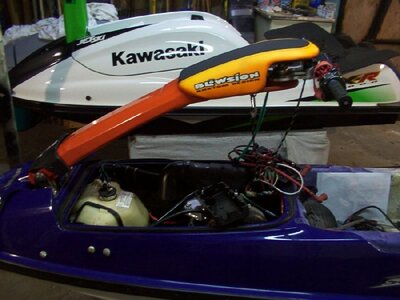

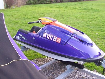

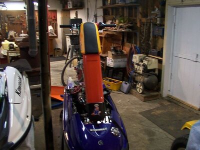

you cut and rewelded an ac pole? Pics please??? :sneaky:
yup... and powder coated it... you cannot even tell... the pic with the white pole is the before picture.
The plate welded to the top of the pole, just below the pad is a reinforcement plate... after blasting the old paint off we discovered a crack there.

After shortening an AC pole, I never want to deal with that again.

HMMMMMM interesting coment. Frosties looks good though and not many -3 A/C's out there. And A/C is the best pole ya know, it aint sexy, but it aint gonna break in my lifetime.

Don't let Brian tell ya how hard it was... :wink:
Afterall, you know you have another pole to do yet Brian... There's an AC pole on my SN that needs shortening and fresh powder coating... :biggrin:

I would have to agree, that it is the strongest pole out there. The 1/2" tubes that run down the inside make it very strong. Hopefully the RRP will prove to be very strong also.
If you have a tig and know how to weld AL you will be all set, it just takes time, some 1/2" AL rod, and possibly some spare AL, to patch with. That skin on the outter cover is very thin, possibly 16GA, and somewhat brittle. We cut at the top by the chin pad, because that was the most square place on the pole. I would have rather cut at the bottom, but it looked too hard to line up after cutting.
What, I thought it just needed powdercoating?! :scared:

well my pole is at the welder.. I was looking it over and decide that since everyone is at -4 inches why sell a alum pole when all it needed is 2 inches chopped out of it...
So the pole is already cut -2 inches at the bottom and I cut 2 inches out of the top. Right where the 2 angles are so that the pole sits flatter in the hood. I ground it all down and got it ready to weld.. The welder quoted me $20 to tig it back together. So I now have a -4 inch AC pole for $20
I will post pictures when I get it back. He is going to grind it down so that I will just have to paint and install it.
