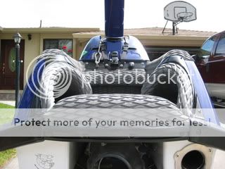

Do you have a kick pad molded into your turf...? With my XFT holds I molded up a pretty sweet kick pad and secured it in just the right spot to where my heals are locked in from scooting out the back but still can easily get my feet out with a little wiggle.....I am kinda shocked you didn't stick with your XFT's....
Here are the pics....

Are you usng the 25mm underpad..... This has really helped out my footing and turf work because you can shape and mold as you please..... This is what I did with mine before laying the turf over the top.
