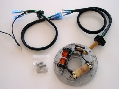

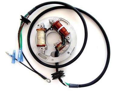

How can you tell the difference between stators visually???
#ZERO
Beach Bum
Florida - U.S.A.
A picture always helps.
The 61X is on the left and the 62T is on the right.
Notice how close the pulser coil is to the crank snount hole on the 61X and on the 62T it's mounted further away.
Also notice the six round casting marks around the outside of the aluminum mounting plate. The 61X has only round circles while the 62T has half moon shaped marks with the raised circles.
thanks..your the man
