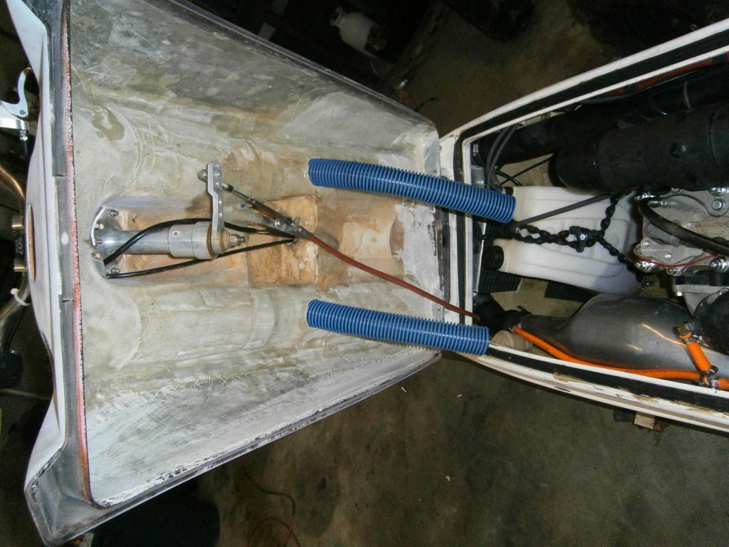

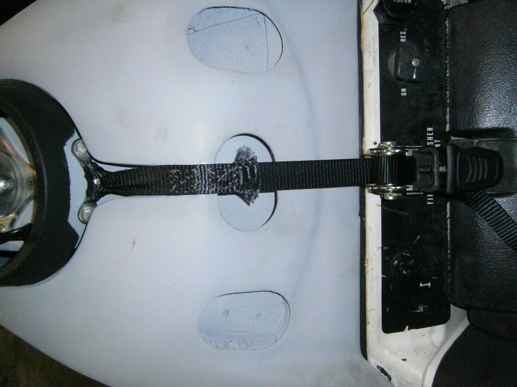

had a few people ask about this hood so i went out and took some more pictures when i got off work this afternoon
the engine in it is a friends 701, he cracked his superfreak and needed something to ride for the rest of the season. hes got a prop and a bored nozzle for a pump setup, and shortened OEM ride plate. the thing still planes out and takes off. Im extremely happy with the hood. CarterB said his customer had it but wanted to sell it for some reason, i am unsure whether he made it or bought it from someone. if i can answer any questions i will. I really cant wait to try this thing in the surf when i get my stroker motor done for my RN, the old motor will go in this. the goal is to be at the daytona freeride with it, rockered and painted with a 718 and mag pump.

ProSouth, I made that hood. Heres the build thread and the for sale thread; I lost a buunch of the progress pics somehow.
I had added some 3.5 inch bar risers to it. It has a cut down UMI WaveRaider steering on that's cut shorter inside of the hood. (Would have hit the spark plugs w/ stock length)
Be sure to silicone/5200 those breather hoses to the hood liner.

lol funny you say that about the breathers, i have only been running one because the other falls out (like a hotdog down a hallway). great work WAB i love it. i do want to raise the bars a bit. but still fun
