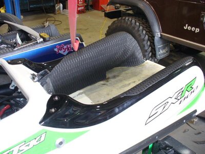

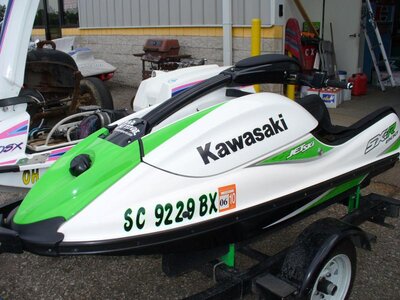

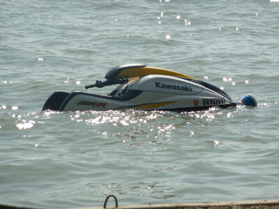

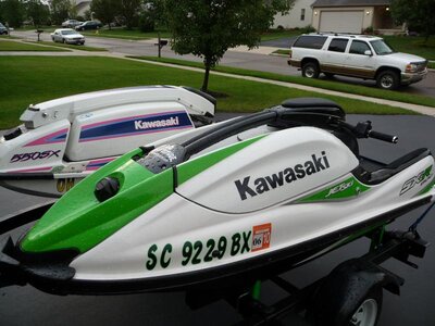

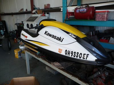

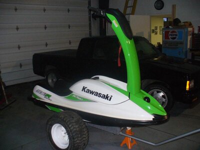

here is my 07 sxr
had some free time so I thought I would give some info on my ski
07 sxr I bought from sc in dec of 07 (it was 5 months old)

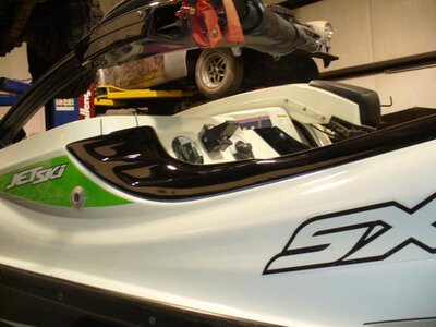

brought it back to ohio & we had a 65 degree day so took it for my first ride, that was efn cold. took it to daytona to ride it the second time & had a blast. I cracked the pole on sat & so began my obsesion with improving an already kick a$$ ski.
I started with;
Dales jet sports handle pole.
0 deg bars
odi clamp on grips
tbm hood hooks
pulled intake boots
first 2 pics are the ski on its ride home from the south
other 2 are more recent but shows off the pole

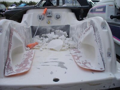

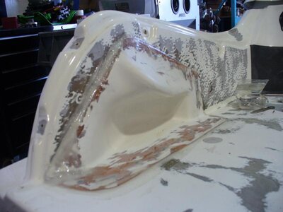

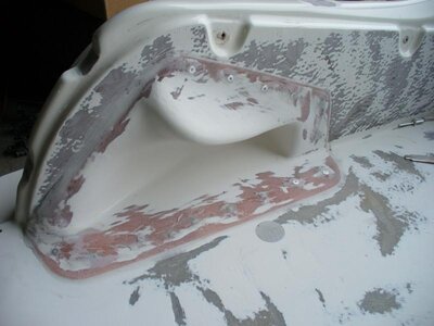

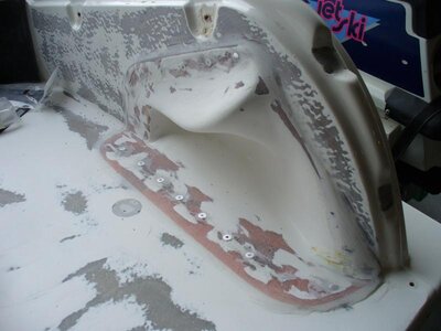

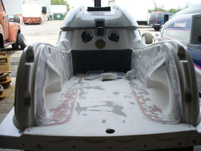

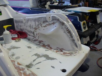

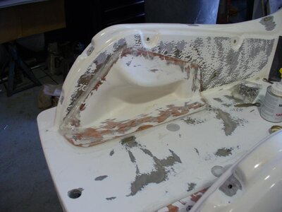

so after daytona I realized I needed footholds so out came the saw. So I called john @ jet ski haven & ordered lustic footholds blowsion rail caps & a bilge set-up.
I also had him send me an aluminium bed plate while I was at it. -2.5 pounds

more pics of foot holds going in
I after I ordered the blowsion rail caps I found the jet trim ones & liked them better so I ordered the trim caps & they were very nice. They fit with min trimming & had a nice finish.

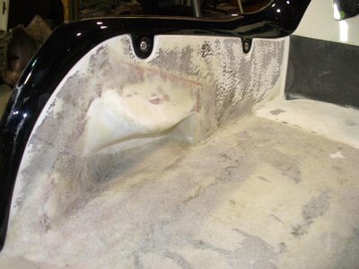

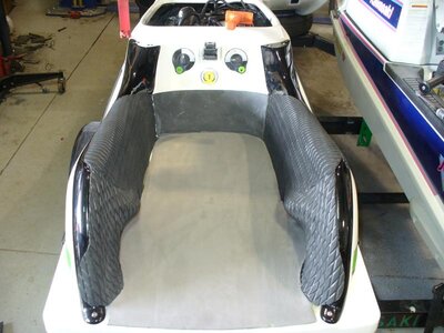

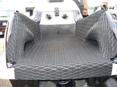

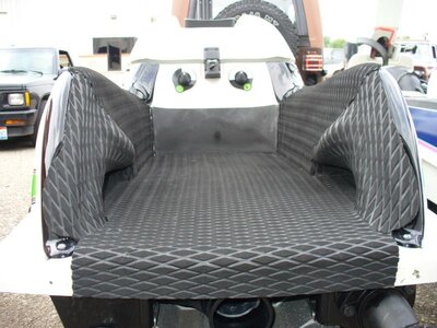

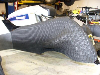

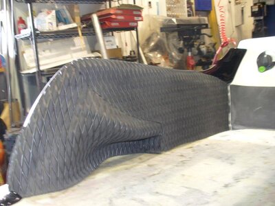

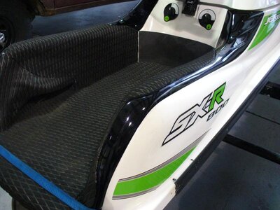

my first time turfing, I got a med sheet of pad for the deck & a thin sheet of pad for the tops of the holds. Full sheet of black diamond hydro turf & lots of sniff'n glue,,, I mean contact cement
some more of the turf

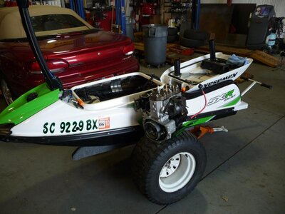

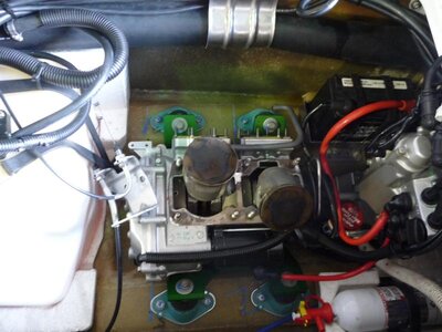

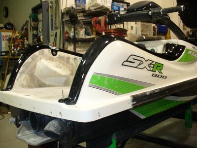

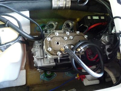

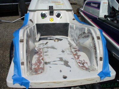

the turf & holds were done so out came the motor.
replaced the bed plate with the aluminium jet ski haven plate.
cut out some glue. wow is there a lot of that in there & I am not done yet. I will finish this winter as I got tired of cutting glue.
installed a light billet coupler -100 grams from stock
reinstalled the engine in the ski & went riding

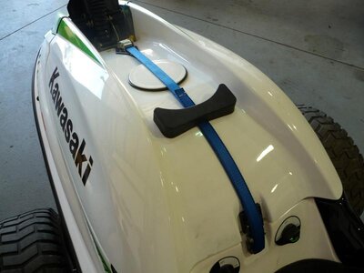

had some problems with my loose hood so I made a hood stap & got rid of the hood latch all together

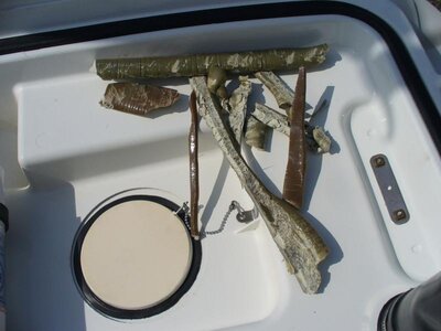

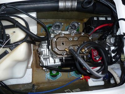

so 2 months ago I found an 06 sxr with the full group k 832 sleeper..... so I bought it, much to my wifes shagrin.
swaped out the top ends, carbs, cooling mod exhaust, cooling lines & fittings, cyl head, lightened flywheel, impeller & bored nozzel.
also put the works scoop grate on & it was nice this weekend @ Indian Lake (very rough on the weekends) but I need a stock intake for waves.
also a pic of the doner ski

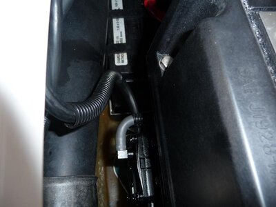

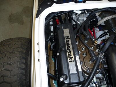

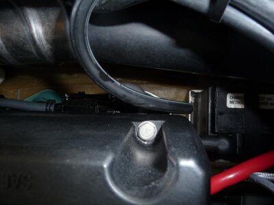

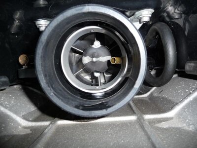

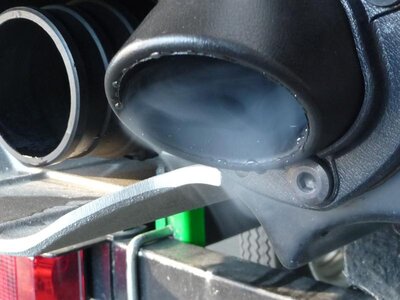

glad I pulled the motor when I did. I found the fuel inlet line was rubbing through on the air box.
pics of the rubbed line, and after I moved it. also a pic of the bored nozel

I picked up a stainless u-bolt & carabiner for below the latch & just tied 3/8 line around the bar plate. dont know if that will work but for a qwickie install it should work. got to find a bungee stap in my piles to keep light tension on it.
