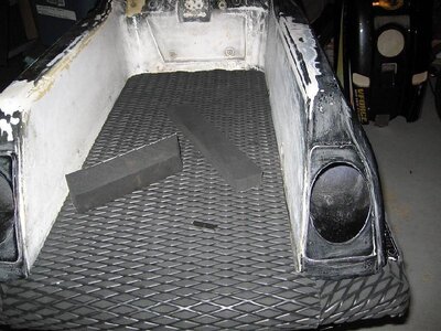

o.k. i'm trying to get my ski done but having a little problem with installing hydro turf. i'm trying to install lifter wedges under the turf of the tray sides, i've managed everything else but don't really want to screw this up (as you only get one shot to make it look and fuction properly. look below at the pics and some please give me some suggestions. i was thinking that i would leave it flat on the bottom so i could stay hooked in it when i'm airborne. thanks in advance:banghead: also does anyone make like a low profile cap for the extinguisher and tool compartment? since i took the trays out the handles for the caps look retarded, dee dee dee!!

you could do it with the flat on the bottom. thats how theyre supposed to be, id assume. just dont put any turf on the bottom. youll end up cutting a 'flap' in the turf to make it work.

Find a placement where you want your lifters. install & radus the edges to wrap the turf over. useing a heat gun, warm up the turf to make it pliable enough to be able to wrap over the lifters. relax & use a lot of patience is probably the best advice. Having some one to offer a helping hand is probable another!!
