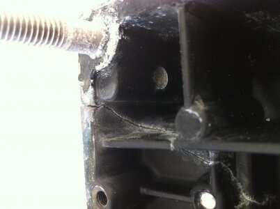

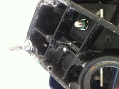

I have a 2010 SJ and just reinforced this winter. I ride surf and when I pulled my handlepole, there were spider cracks all around the bolt holes for the bracket. I layed down some 1208 biax under the bracket area and am going to make my own aluminum backing plate. Making a new limiting rope too. I destroyed the Blowsion one I have.
That's what I wanted to hear, thanks. Next year ill do it when I get whole new steering and pole set up. I have shmittys bracket for quick throw on 08 pole and its frozen in there. I know it will break when I try to remove it and I already locked up the pump in the rear. I already have enough on my table. I will hope for the best with the blowsion bracket. Thanks
