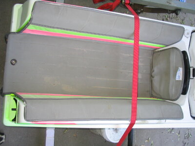

I just re-turfed my SXR and love the result-heres wut I used
Hydro-turf oem Polaris B-stock=25.00 per sheet or 40.00 for 2.
Go to Lowes to the floor covering section-there is a 4pk of 1" thick foam rubber padding that interlocks together. The stuff is 16.00 for 4 sheets in a pk. Open the pack and take a sheet out-use a razor blade to cut the inter-lock tabs off and cust u out a foam tray pad-sand both sides of it using 40 grit sand paper-glue it in using Dap Weldwood Contact Cement-READ the directions on the can-beat the hell out of the pad w/a hammer once glued in-now cut your hydro turf and glue it to the pad. Now u r good 2 go-soft yet strong and should last a long time.
