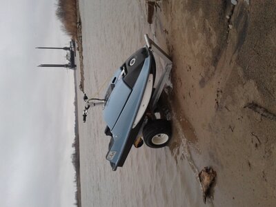

Here is a little update on what's going to happen this winter. Right now just fabbing up a new steering stem (I like to make things, sometimes they work, mostly they don't lol) I'm trying to make this work on a reinforced stock hood, with stock hood liner (I'm tired of water getting into my hull). I'm also going to be doing a 144 solas pump, with the same setback as the f1pro. I'm fixing up my f1 during the winter as well, Lots of work to do there. A couple of pics with lots more to come as the cold months are upon us...

I still have the carbon overlay hood, I just wanted to try something a little different. (If anyone is interested in buying the carbon hood with the acusteer x2 sten just shoot me a pm.) Here's a couple of updated pics. I did a little more tig work. This should look like a stock hood, except with a fixed steer stem(hopefully).
