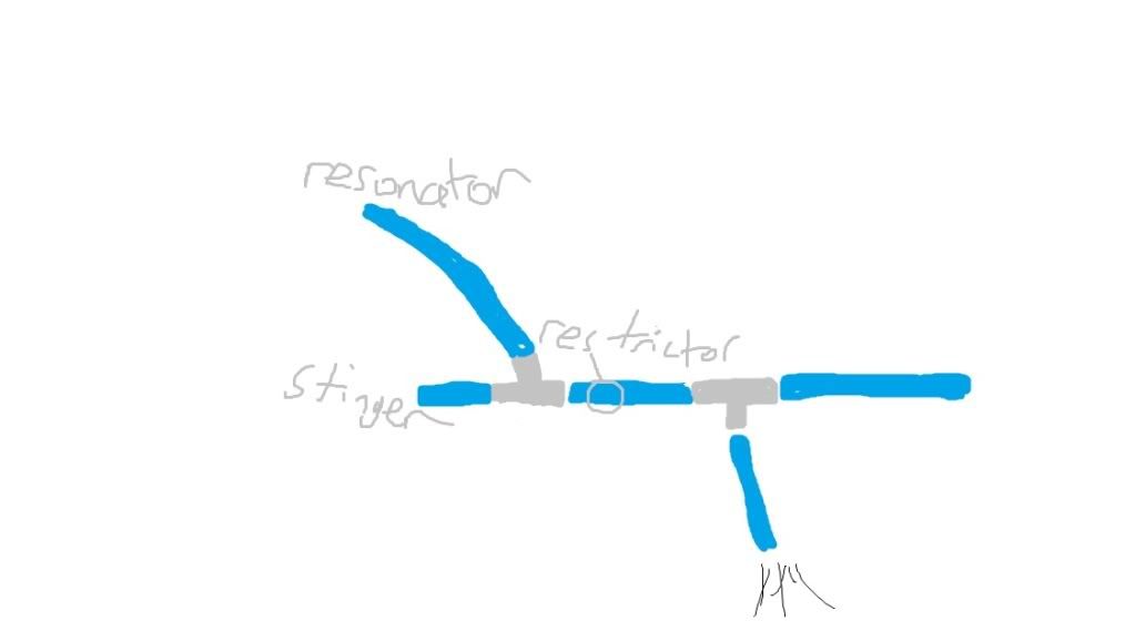

are you running dual cooling? If so where in the cooling loop are you running your pissers, and how many? Im just trying to get ideas, Im running dual cooling both to the manifold, and i need to get water to my resonator also.

yes dual cooling .. both in coming lines to the bottom of the manifold.
one off the head to top of b pipe
one off head out the boat ( pisser)
bottom of b pipe to the stinger t'd twice , one to a pisser .
one to stinger ( restricted)
and one to silencer
hope that makes since.

thanks a lot! so the line from the bottom of the pipe to the stinger, you have t'd twice, is the pisser t first? So itd be like this from the bottom of the headpipe?

I started that way exactally ... but Ramjet said to only restrict the stinger ,(full stream to the silencer /resinator)..so I moved it after the T .. other than that your spot on mate!
