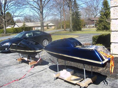

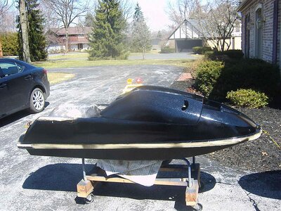

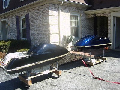

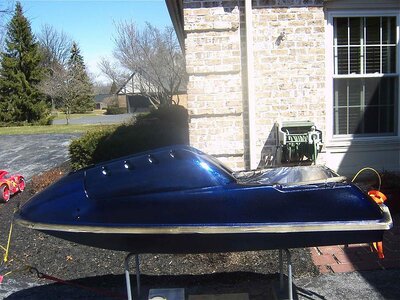

adding pics for goose :biggthumpup:

The ski built the topdeck is black with gun metal flake in it and my buddys ski is black with blue flake in it.its time to turf and start putting this thing togather
