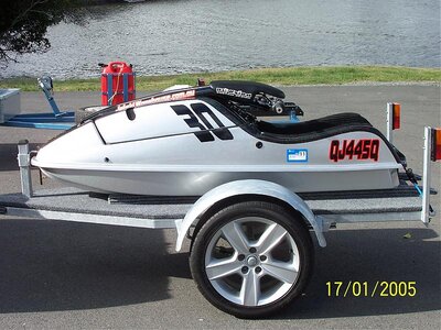

It sure was good to get back on the water again. Saturday we started dialling in the motor. Thanks to wax everything was pretty close. One jet change and lower the pop off and we were pretty much there. The pump felt good, the steering worked well but I will be trying to get it steering a little faster. Sunday everything felt great, the motor was getting faster & faster with more tuning and then the cooling blocked. We couldn't clear it on the beach so that put an end to the day.

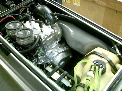

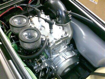

Today I received my ADA head. The engine is finally complete. Bring on the weekend!

Oh great. The reason I chose the Fx1 for this project was because I like the way they turn. I like that old school Kawasaki type turning. I thought that I was tipping off the side because I was out of touch. I didn't realise that the pump conversion would affect the steering as much as it has. I also have all my settings set as extreme as possible. Maybe a longer steering nozzle might help???

Handling has improved alot with the JD ride plate. The nose of the ski is still not coming around as hard as I would like through the turns. You're really busy in the tray trimming back and forward. You'll be carving out a nice tight turn, then all of a sudden the back end will slide out. It is getting alot better with time. I tore the scoop grate out the other day riding in the mangroves. It broke into six pieces leaving the hull inserts and pump shoe undamaged and the prop with only a tiny chip in one of the blades. If anyone has a grate that they want to sell please let me know. I wouldn't mind trying an old two bar grate with all the scoop at the pump shoe. I think the intake area is too small for the top loader style grates.

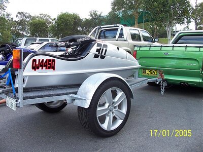

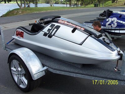

Finished At Last :Banane01:
