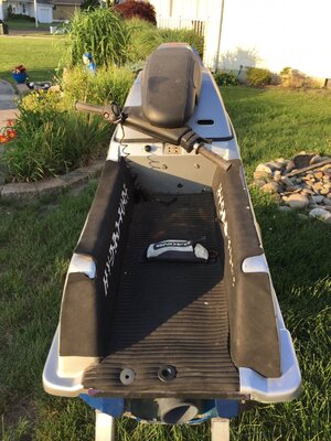

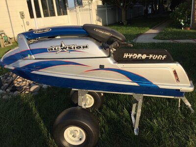

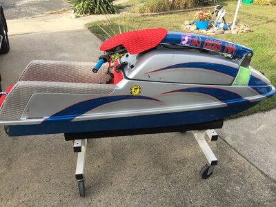

I bought an fx in June 2015, stock body but the last owner put a 62t motor in it. I rode it a couple times without any mods, but it needed improving. Here are some before and after pictures of the transformation.
Baby Pump ^

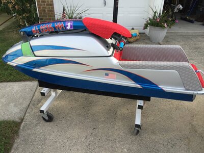

Now for the Post build Photos

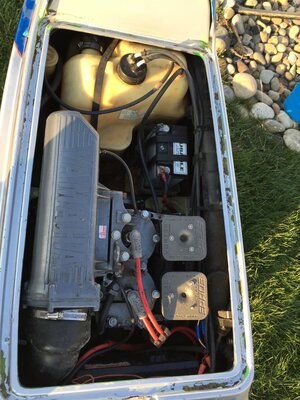

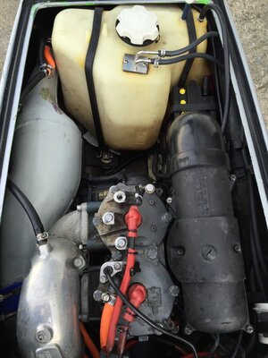

Started by putting a fresh engine in the hull, next I had to get a superjet tank so I could make it through creek rides, last thing to wake it up was to put a b pipe on. (I bought the ski with a factory pipe water box as well)

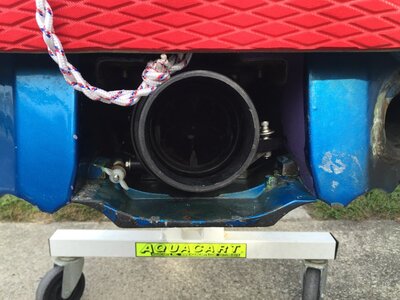

Now for the most important mod, a kawi 140 pump conversion. It's like night and day compared to the stock pump. While doing the pump conversion the sides were also reinforced with carbon.

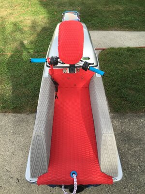

Next was turf
So there it is, it took about 2 months do. I still have some small areas to turf by the pole bracket and the rails, but it's now a running ski that rips.
