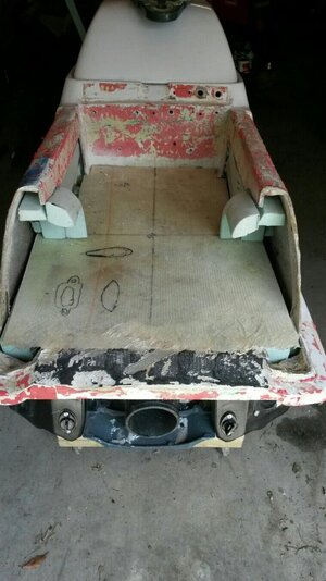

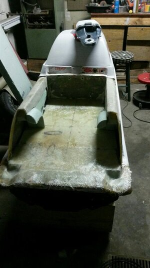

So update time. I had installed a foot strap in a bad spot and didnt like it. So this winter I decided I would make my own foothold. After cutting into the tray I saw water. Poor job on the resealing part. So I installed some drain plugs from @JetManiac then I reinforced the gunwales since stock are kinda flimsy. Then I made some footholds out of eps. Glassed in the laminate and now just have to do the sides and then a few more layers in the tray. Then I got board with the stock length pole and cut 3 inches off of it. I also picked up a quick steer plate from @KTM434.

Wide tray was good but not having footholds sucked. The pipe is great but I need to restrict the water injecting into the pipe. At lower rpms it dumps too much water and puts a minor bog on. Once it clears it rips the arms. I like it. And the top end Is pretty crazy.
I will post some pics of the water box tonight along with the engine tear down and what I get done with the glass.

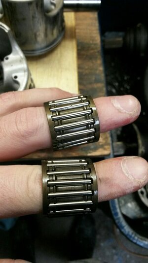

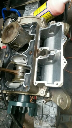

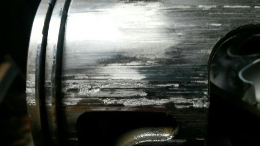

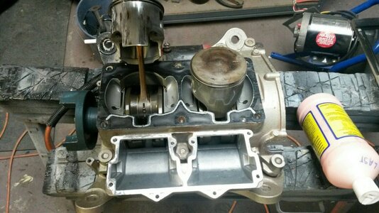

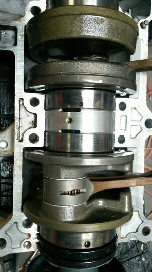

I got the engine all torn down.
Good news - don't need a crank everything looks brand new. Just need to buy a set of seals.
Bad news- rear piston is licoriceed. There are some missing pieces to it. I'm pretty sure the piston for a little too hot.
This motor has never been torn down. There is still factory sealant on the base gasket. You can also still see the factory cross hatching on the cylinder walls.
