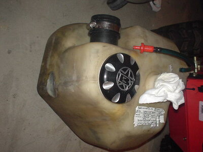

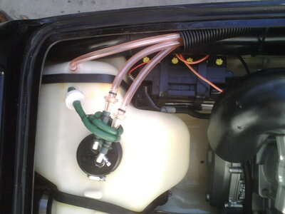

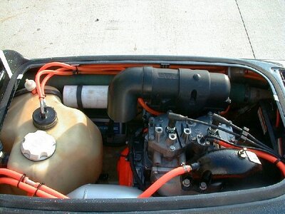

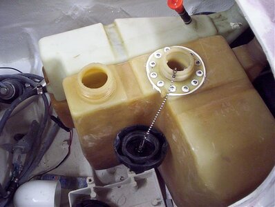

Can someone post a pic of the setup? I want to do the same thing.
I have about 6 inches of hose off of the check valve and hook it under the left gas tank strap. I don't think it matters but that check valve is under water if the ski floats upside down for a few seconds being that close to the hood.
