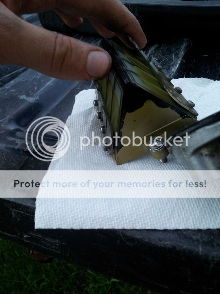

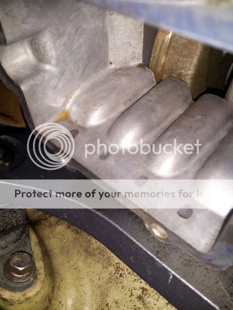

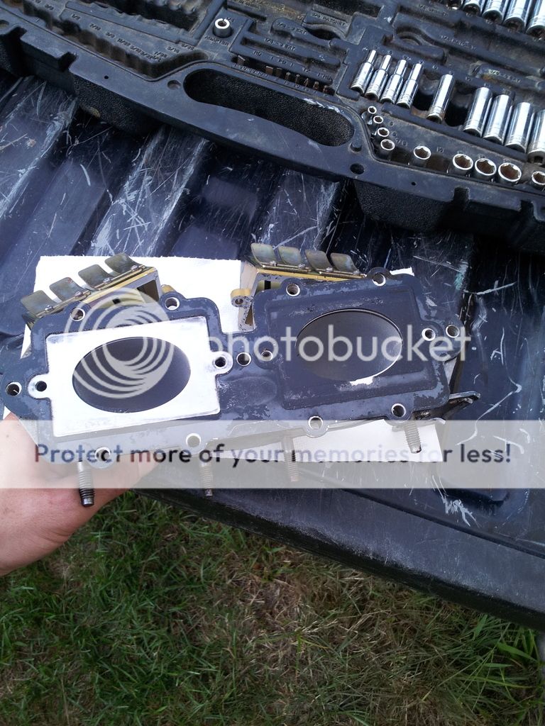

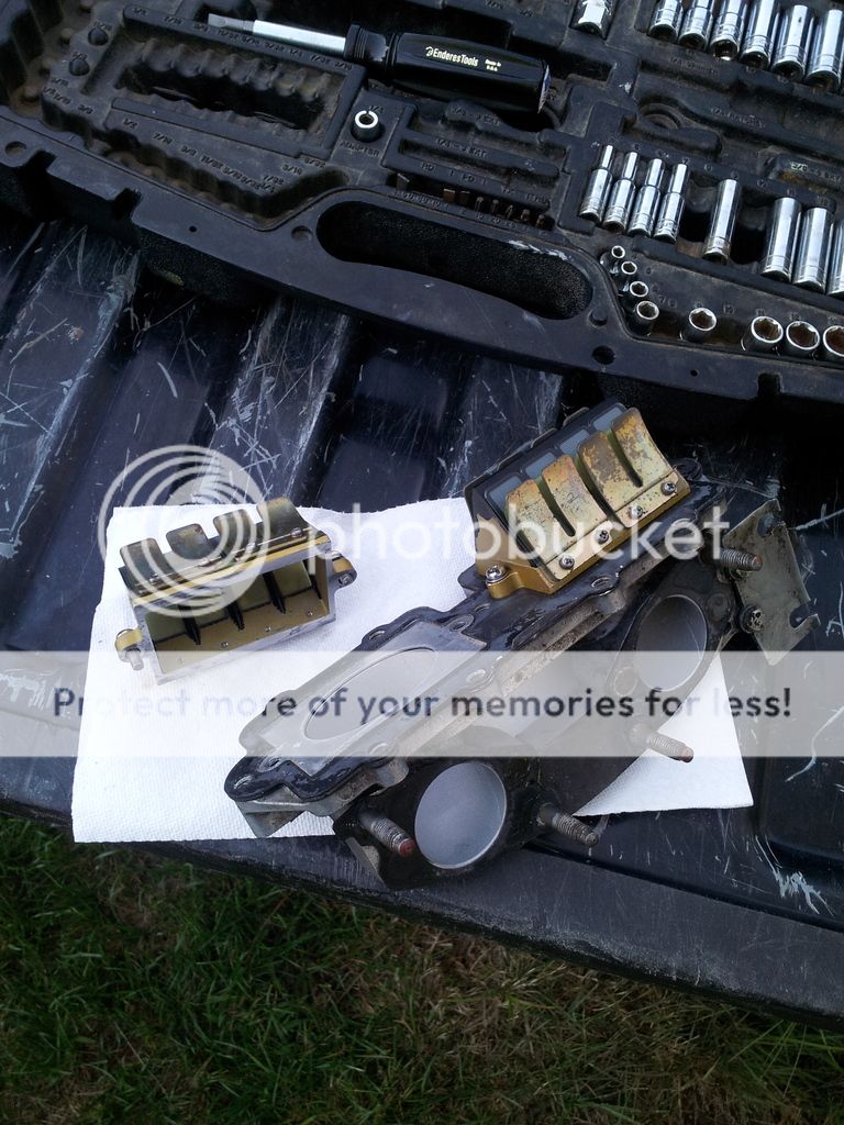

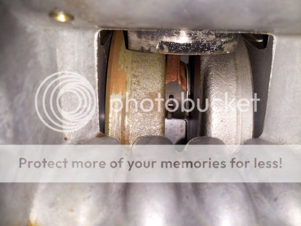

With the F/A off the PTO carb spits out fuel from the intake, when going from full throttle to idle (letting off the throttle). I took the carb apart and looked at the needle and seat it looked fine and when idling there was no fuel dribbling out. Is it the reeds not sealing properly and letting air back through the intake? I have to wait until I get home to tear into it further.
