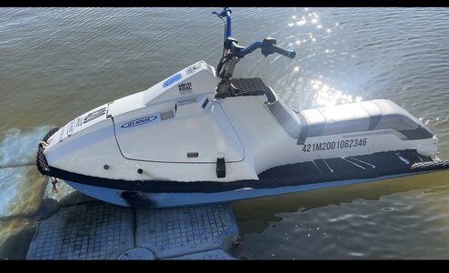

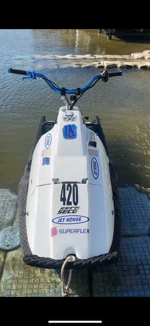

I have an x2 and two spare hulls and here in Brazil we only find stock hulls. I'm thinking about doing the same thing that Crab did. As in Brazil and everything is much more difficult, I'm going to do it with foam and fiber. I think it will be very good for what I want to do, from what I read in that topic.
I don't have a lot of money, Brazil isn't in a good political and economic condition for some time now, and for me, as a mechanic, it hasn't been easy at all, but I keep trying to invest in it out of love, I'm 23 years old, I have a lot to do. I still work and achieve, so I want to have fun and learn a lot in this life. Tomorrow I'm going to the waves with my x2, I'll leave some photos here. You were talking about the original x2, my father has a completely original 0km one, the most beautiful thing, even the original stickers, a beautiful x2;
I'm very happy with the way it is, I think the only thing that would change would be to cut the rear a little and put the trim in the hand, my trim is fixed a few degrees up
