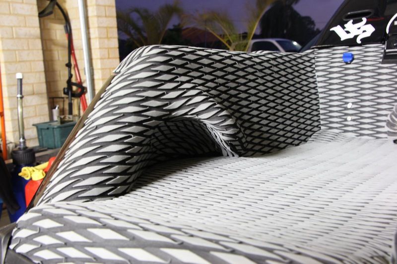

nice looking boats, and pics of the tray area? whats the width compared to an SJ?
width is the same mate. just 100mm shorter than a SJ. the tray has been widened and the footwells are crazy deep for the extra hold ;) .
Pete sells just the footwells as well on his site www.fpjetskis.com for anyone looking to chuck them on their ski. these are some i put on my mates SJ last year.

its about 75mm wider than a superjet 3 inches maybe don't use inches here lol i was trying to upload a pic but it keeps freezing my mac anyone else having problems ?

I widened the tray by taking the side of the ski further onto the rail, you will see in the pics that brock put up that the rail is half the size at the back , i then also cut the sides narrower and relocated the exhaust , this mean my lifters fit all the way to the outside and actually are glued on to the side of the ski to give the sides strength , so the complete area is about the same as an SXR which makes riding easier , plus the ski has more foam than others skis so will float well when sunk and a full tank :) my email is peter@fpjetskis or freestyle.pete@hotmail.com if you have any questions
