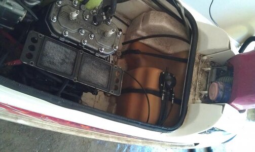

crankcase drain
The cable on the top of the pipe you pull in case ya sink your boat to drain most of the water out, but if it leaks it can be a bigger problem so Most people get a block off plate. Their about $10.00
Straight down from the exhaust manifold. Youll have to pull the engine off the mount plate and I think you also have to remove the starter. No big deal really, only takes a few minutes to bolt on.

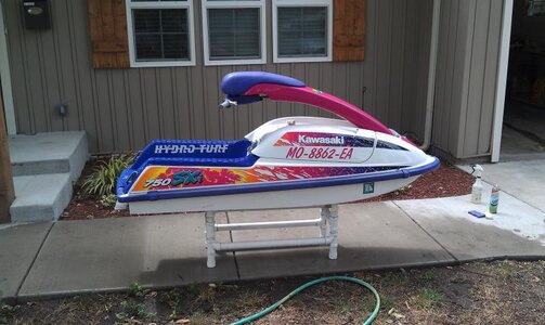

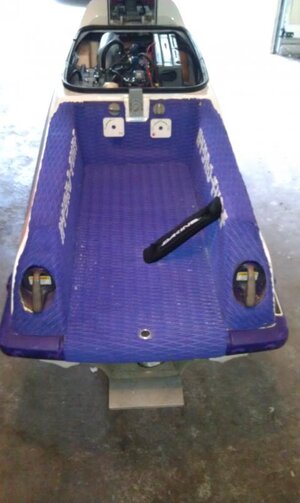

I still need to put in the other strap, but she is finished! It has not ran in five years and first push of the button she fired right up. I was a little surprised.:cheer:

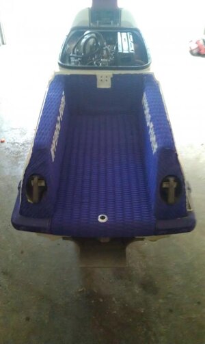

Is that the 100.00 Hydroturf kit I saw on ebay? Looks good.. I may go that route, going to go with black ... Now hit the lake!!!!!!!!!!!!!!!!!
THANKS! yeah, it is the same one. I had never turfed before so I went with pre cut. If you order black you will get the turf quick. I went with awesome purple so he had to cut after I ordered. The kit fit perfect. Now I just wish I could find a cheap pipe. If you see one, keep me posted.
