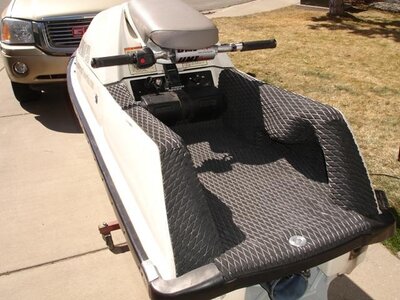

WCF on my ski
attachment.php
attachment.php
