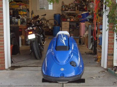

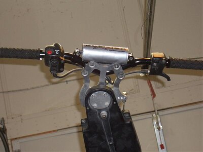

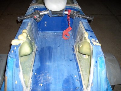

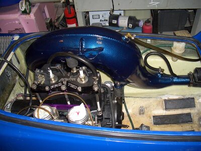

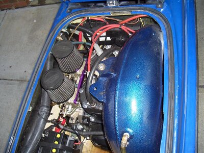

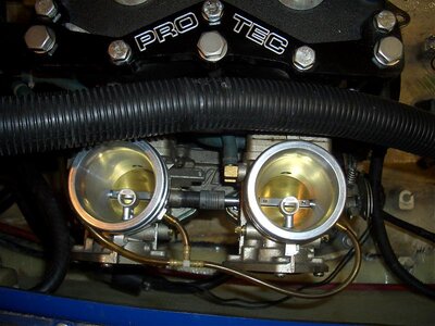

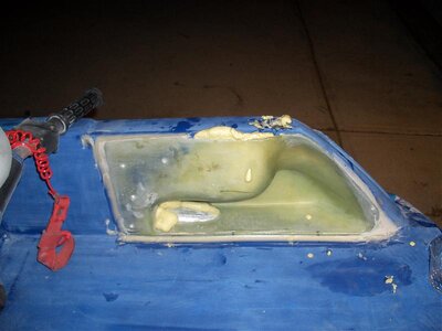

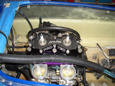

Its for a type 4 w/ water injection, novi maxi flows 48mm I think, MSD enhancer, worx pump grate/stuffer, SS prop, UMI steering, carbon tech reeds, pro tec limited head with girdle, and soon UMI zero degree bars. I think that's it:biggthumpup:

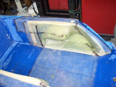

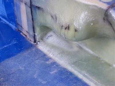

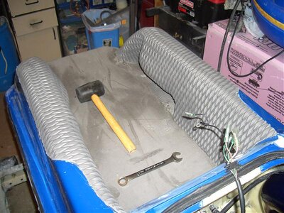

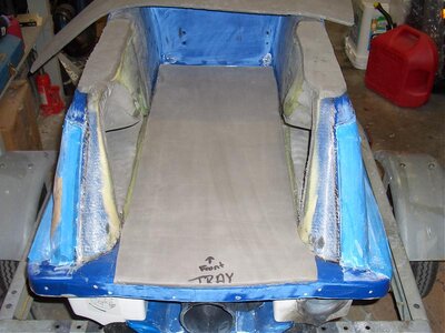

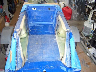

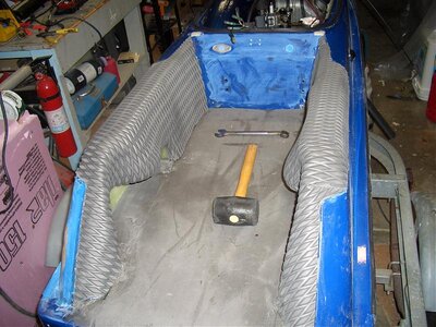

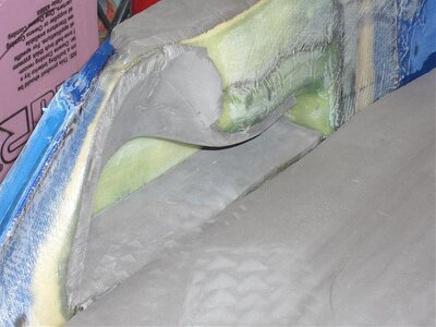

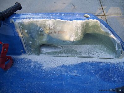

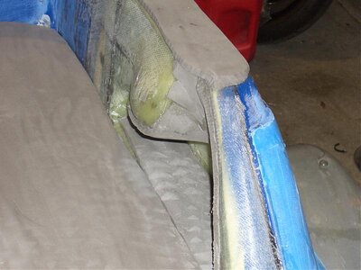

* Yes, there will be some 1208 biax in the tray with a layer of some cloth thats been hanging around my shop. Hopefully I will be reinstalling the motor tomarrow:woot: :Banane01: :biggrin:
* I plan on ordering a billit finger throttle and hood hooks and suggestions?
