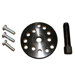

The universal jet ski flywheel pullers work the best but you may be able to find one at the auto parts store that might work well.
Tyler Zane
Open Your Eyes
advance auto parts has a loaner tool that works great (i work at one). get it tight and tap the head of the middle bolt a few times and repeat. or an impact on the puller will take it right off in 5 seconds.
used the harmonic balancer. it worked fantastic and even had the 8mm bolts in the set. it was about 14 bucks. however i did find out not to use the cone shaped adapter on the middle bolt. all it does is push on the flywheel and doesnt allow the flywheel to come off.
