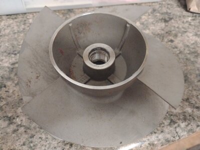

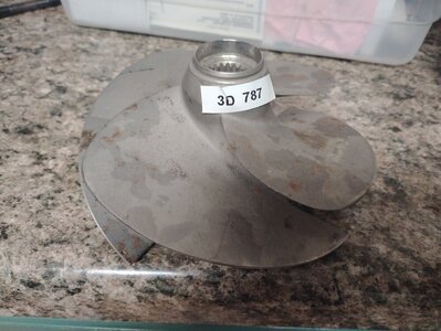

I have no issues swapping stuff but it has to work when I get done , period, I won't let one go out the door unless it is right and tight , call it a character flaw, old school values , work ethic whatever , it's the right thing to do , I sent you a message about the impeller , if it comes down to it I do have one on a ski here but I would prefer to leave it with the ski, what I do a have is a brand new 3D impeller here and I also one out of my 3D as well , those are both 787 RFI 155 mm big hub impellers and should work.

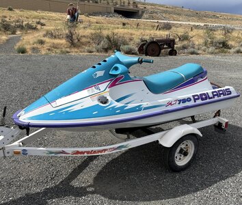

I rebuild this engine last year and today i got a phone call from the 1 Owner only Owner of 1994 Polaris SLT , always garaged, all paperwork in place, even the Manual (posted the MFD instructions know some people were looking for that) ..... and .....and .....and ....... she gave us the ski for free ... ?? Im like you can sell this and make money, Im like I can sell it for you .... but she insisted that it goes to a good jet ski family and wanted us to have it for free ...... She is 82 and decided to just keep her 2017 yamaha 4 Stroke.
