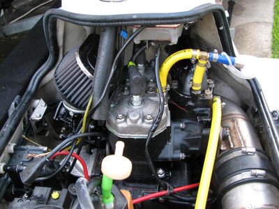

Ok I have a few questions. The ski runs great but I been looking over and wondering a few things. Ill post pics up to show what I'm talking about. I was told the ski was all stock except for the carb. and the head. so anyway ... 1 how many cooling lines is there on a stock ski?I have 2 going into the hull but theres only one thats hooked up to the pump. the one that is hooked up to the pump runs to the exhaust. the one not hooked to the pump just runs to the back of the hull goes to the exhaust manifold. Im sure i Have most of you lost by now so I hope the pics help.

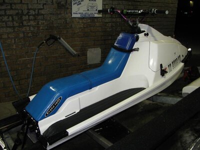

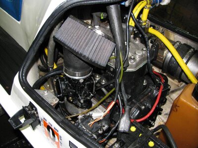

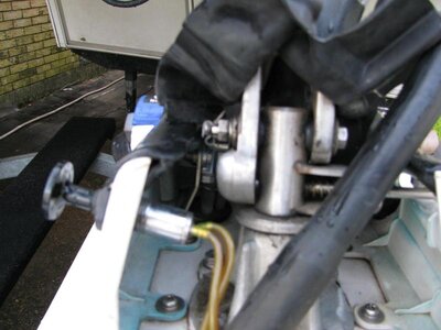

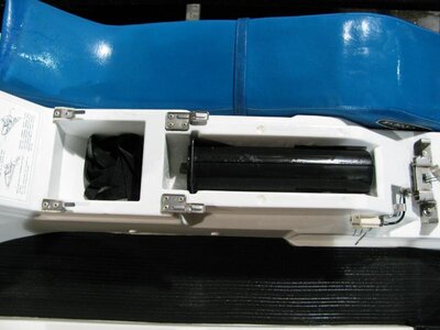

Just some pics of the ski let me know if anything looks out of wack to you guys.
