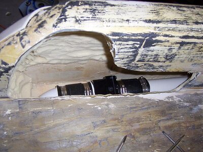

As of now, the motor is at the shop getting bored and I will have it back midweek next week. In the mean time, I cut holes in the tray for some REV's and at the same time putting in a oneway. I epoxyed the oneway in last night and installing the rest of the REV's this weekend. I will post picks later tonight.

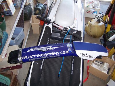

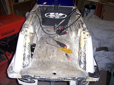

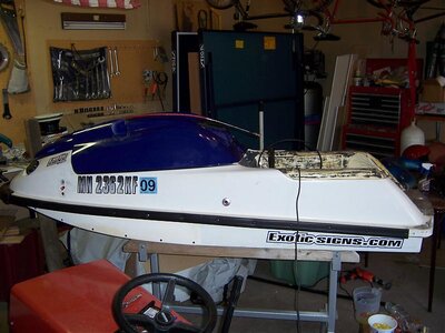

Nice! Well here are some pics of the ski. I have some mismatch colors, but I won't change that time the riding season is done up here. I just want to get it done to ride while I can.

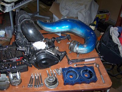

Oneway and footholds are installed, waiting on turf. I picked all the motor stuff up from speedwerx yesturday and should have the motor back together by tomorrow and dropping it in the ski!

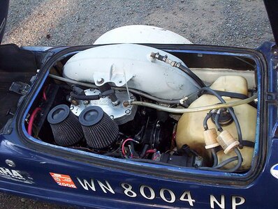

I made a lot of progress over the weekend. I have the motor together and installed, the pipe is installed, cooling lines ran, everything in the pump area installed, everything with the pole is installed, hand holds installed, and have the turf is done! Hopefully be able to finish it up tonight/tomorrow and on the water Wed. I will post pics tonight!

Well, I got the rest together and just need to clean up fuel lines and misc. lines, mount a primer and turf the bottom of the tray. I was able to fire it up last night and it seemed to work good! Have to wait and see how it works on the water on Wed. I will try to get updated photos tonight after softball, I was too focused on getting it running last night and ran out of time to take a few pics.
