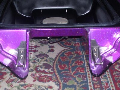

I finally mozied out to the shop to do some work. I figured I needed to get the aluminum flanges finished on my exhaust, and one way valve exits, so I could go ahead and get the tray glued back in. Since I cut the hull back I now had a pretty good angle to deal with. So I took the same aproach as on the SJ exhaust and made the same style flanges to hold both the tubes in place. I think they turned out pretty good.

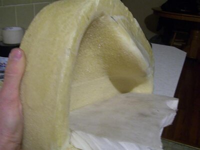

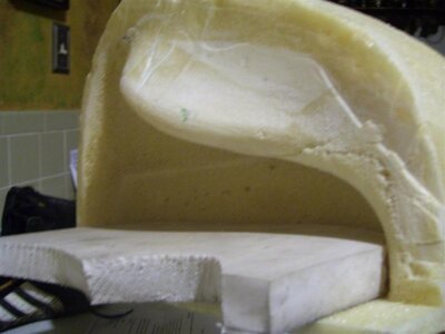

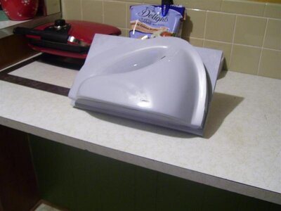

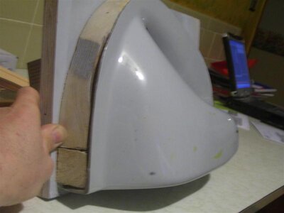

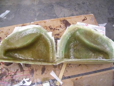

I finally got the foothold molds done and ready to pull off a set. So time for some more glass'n. Yippee!! Here are some pics from the beginning from when I got them shaped out of foam and fit for 25mm pad, to making the mold from the foam, to finished product mounted and sealed ready to pull from.

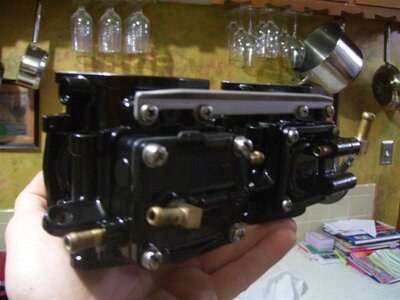

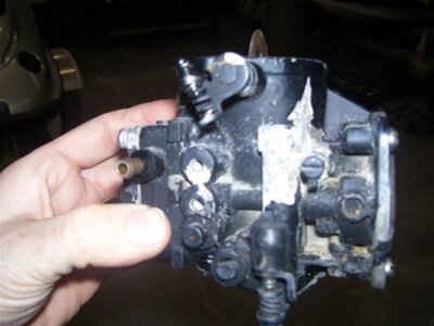

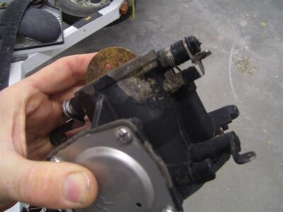

Got the carbs painted as well. And case are ready for paint. Here are a few before and afters of the carbs and of the cases ready for paint. These carbs were so nasty, sand and salt, all corroded, bent throttle plate,and frozen H/S screw, What a PIA. Now all pretty waiting on carb kits.

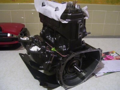

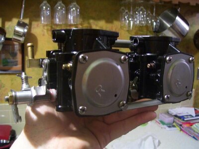

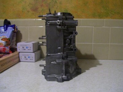

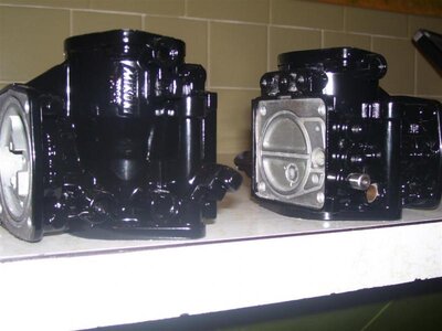

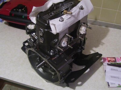

I have not posted an update for a while so here is a few pictures of the carbs all finished and assembled, as well as a few pictures of the engine. I'm waiting on a head gasket from Watcon, then I can do my leak down test. and finish up the electronics, and button the front up.

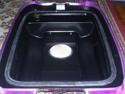

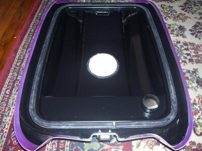

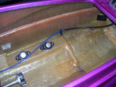

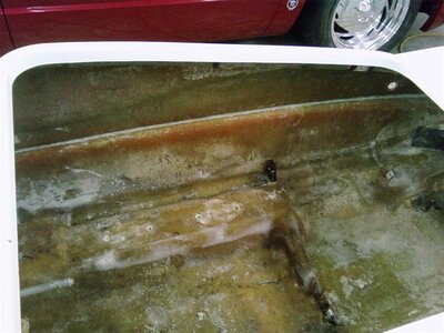

I finally took the time to take some photos. I'm kind of fast forwarding so to speak. So here are a few of the inside of the hull before and after.

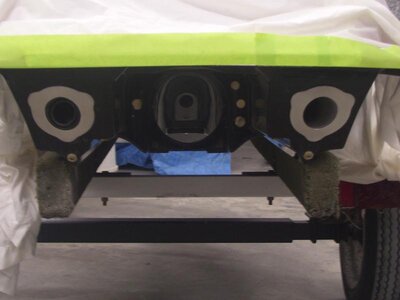

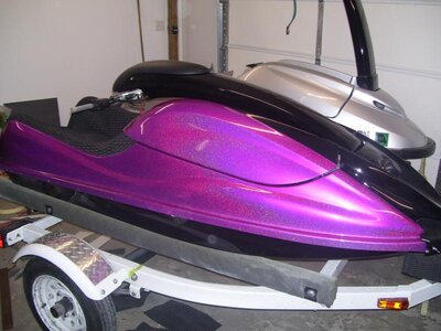

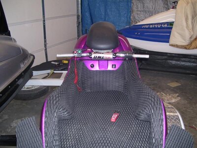

And a few full exterior shot. After I got the hold insalled and turfed.I still need to finish gluing the turf down on the floor. have the pad all down. But ran out of time lastnight. I will try to get more as I go now.
