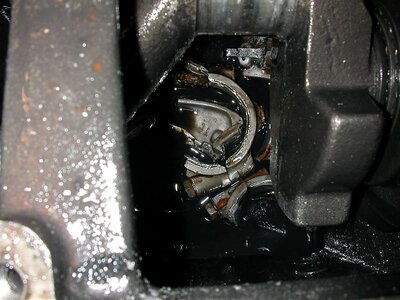

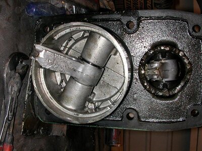

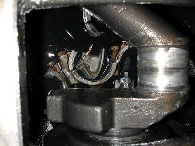

Fast Way To Burn $600
Scorn800
Ride for life
North NJ
Yup, that's what happens. Check the oil weekly.
I must see atleast 1 a month like that. You would be surpised how many car dealers blow up compressor for not checking the oil. We now install low oil shut switchs to prevent that problem.

Didn't you read the owners manual when you bought it .It clearly states to regularly check your oil .
As a matter of fact it's a good idea to check the oil on any engine that HAS oil .
Let me go check mine right now :cool2:

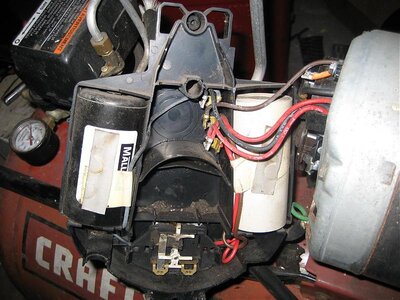

I pluged in my compressor with the cover off and I can see it turns over slowly (maybe one revolution) and then blows a fuse. attached is a pic of some of the electrical parts. I figure one or possibly both of the cylinders are the capasitor(s). there was a mud dobber nest on the contacts on the bottom. I hopped that was the problem but it doesn't seem to be.
any advice? crap. I forgot to add the picture to my last post. I'll post it up when I go home for lunch.
Sounds like there is a start and a run capacitor both. The start capacitor will have a low microfarads and a high microfarads written on it along with voltage for a rating. (Ex.124-175uf, 370V)The run will only have a single microfarads with voltage written. (Ex. 45uf @440v)
If you cannot see them or get to them I can try to look up the manufacturer of the motor to tell you the ratings on them...

thanks, I still havn't tested them. should I plug it in briefly (then unplug) before I test them?
attached is the pic.
No don't plug it in you don't want a charge on them or you will get a nice shock. I have never had one hold a charge though in three years in commercial refrigeration work though. just make sure you take the screwdriver across the terminals first in case there is a charge in one of them.
Also take the wires off the capacitor or wherever they are connected. You can test them from the end of the wires or right at the capacitor as long as they aren't connected to anything...
From the pic the one on the left is definatly a capacitor as for the one on the right it may or may not be would have to look at the writing on it....
