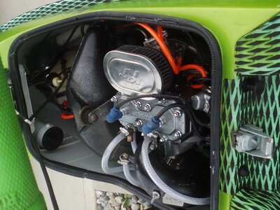

Put a 750 small pin dual carb in my flat deck sx650 this last summer. Have a 750 factory pipe lying around and can't seem to dig up if it will work in the 650 hull. Heard it wouldn't but not sure. Also have 750 fuel tank if that would be the clearance issue?
The 750 factory limited pipe will easily fit in a 650sx hull, not a x2 hull though . I rewelded my exhaust tube to go the opposite way to the waterbox then used a 2.5 gallon kart tank because the 650sx tank didn't fit, awesome power!0711141932.jpg
