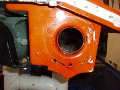

Is the flange permanently attached to the exhaust tube?
Do I have to remove them both as a unit?

the flange is welded to the tube. to remove, you need to drill out the rivets and pound it out from the inside. mine was in pretty tight. i had to have someone hit it with a mallet while i pried w/ a screwdriver once there was a gap.

congrats sho...looks like you have one rivet and some grunt work to go. I'll be trying this sometime soon I suspect as well. And yea, I pity the dope who painted that thang in the first place!
