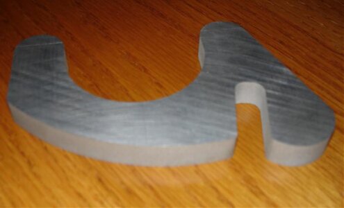

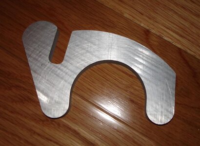

I have acquired some 1/2" thick cast aluminum that I am testing for SXR motor mounts. Has anyone broken a SXR motor mount, or any brand engine keeper? These new mount will limit travel in both directions, front and back.

When I land upside down, "pancake style" my engine keepers of course do not do anything, but if I am at an angle and upside down the bed plate lands on top of the keepers and takes a chunk out of them sometimes. That can't be good for the engine mounts. lol I'm going to make them thicker to stop the bed plate from riding up and over the keeper.

I ended up using 6061 T-6 for this one. This is just a test fit one. If it ever gets above 10 deg outside again, I'll try and see how it fits. This one is thicker than normal to keep the bed plate from jumping up and over the keepers. Also it stops the bed plate from either direction instead of just one. For racing and or just jumping waves, it would not matter, but in freestyle you sometimes land tail or nose.
