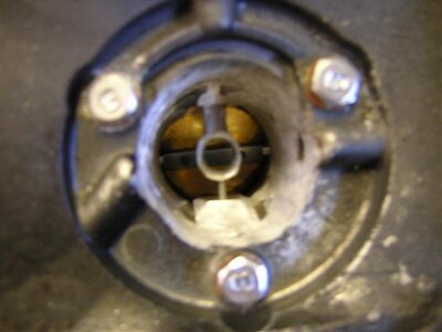

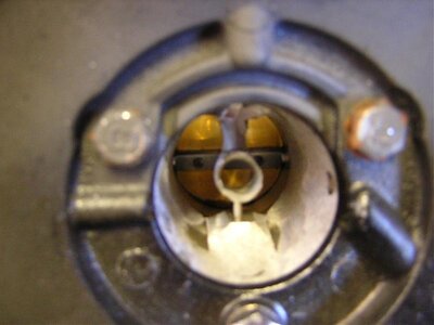

My butchered carbs :tomato:
They use as much fuel as 44's....or maybe it's the operator :icon16:

LOL WAB. no offence but you butchered those! I guess I have a little bit of a steadier dremel hand from shaping dentures.
But you did feel an improvement after you did that? I did this to all my bn44 carbs and there wasnt near as much to remove, just a small support brige and I felt a large difference. And that was on an anemic piston port 550, so im sure Ill feel an even larger difference with duals on a 701. Especially since its such a large obstruction.
And why did you shave down the main venturi booster so much? I would never modify those to much unless I knew what I was doing. Screwing up the jet signal is very easy. Probably should have bored it from the inside out.

I did it about 2 years ago and it did make a difference.
A friend had his done by JSS so I gave it a shot. i did what JSS does....just not as pretty. :moon:

at least use a sanding drum!
I am just trying to figure out how to drill the tiny holes to make it annual discharge!
I dont know the term annual discharge... but from the gist of it Im assuming you mean the booster venturies down the length of the barrel arm? best bet is let a machine shop do that. Or at the very minimum have a killer drill press and lockdown clamp with some expensive bits.

Boring your carbs is going to kill your low end throttle response, that is a mod for higher RPM and speed............ I have ridden ski's with very good porting with stock 38's that had more hit many motors with 44's,46's and even 48's.
But, to each his own.
