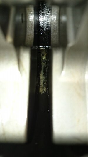

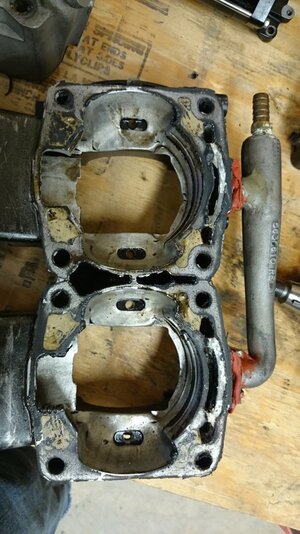

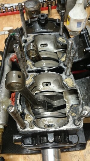

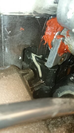

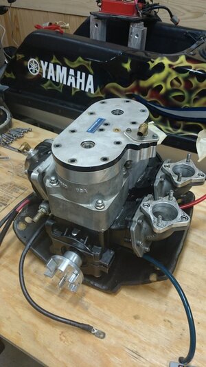

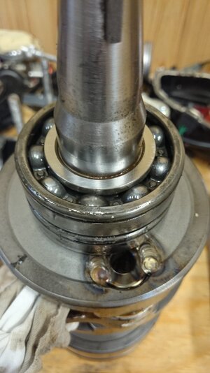

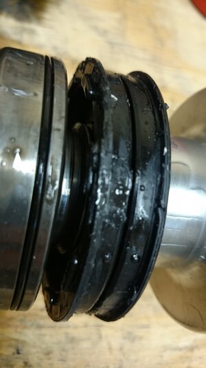

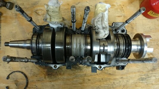

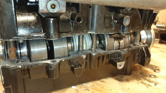

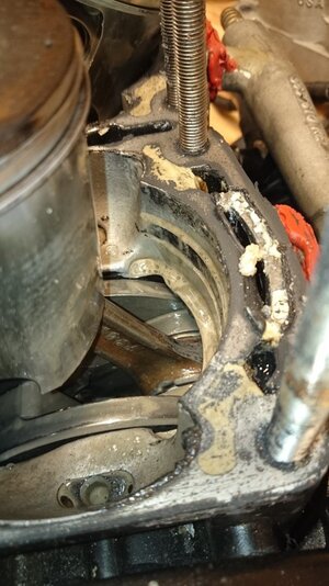

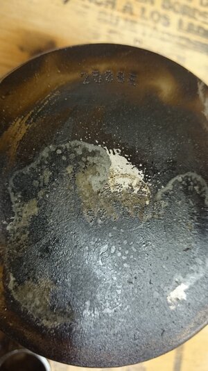

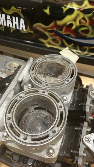

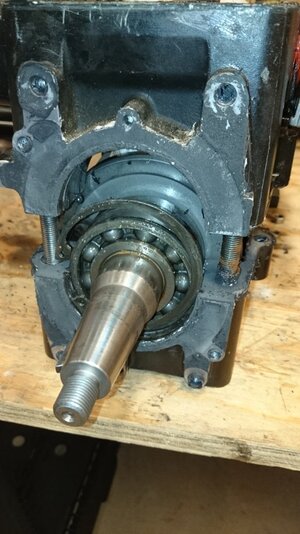

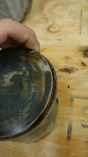

I went to work for a week and ordered a OEM starter. I was going to change it out today. I pulled my tank and the flywheel cover off just to look around to make sure all of the teeth were there and the bendix looked OK. It was bone dry in the flywheel case and everything seemed to be in order. I pulled the plugs, and they looked OK - oily, but OK. With the plugs out I turned the flywheel by hand. The motor turns smooth and easy. As I was looking around I noticed what appeared to be a slug of water in my pulse line! It was. I unhooked the carb side of the line and lowered it below the block and some water ran out. I cranked the flywheel by hand and more water would shoot out with each pulse. I probably got at least a cup of water out of the pulse line before I stopped....
What is the next step here? I didn't get water in the engine due to a major mishap so I have a case leak somewhere? I should do a case leakdown test next and see if I can find a leak? Do I need to split the whole case and look at the crank for rust, etc?
