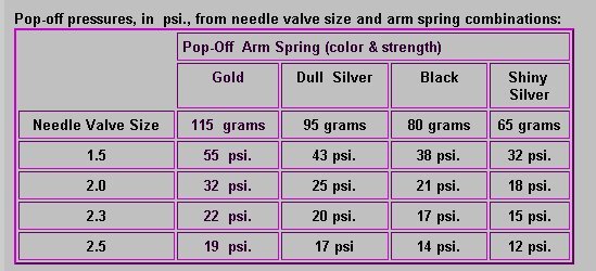

But he is probably running stock 46s not novis or full spectrums. The jetting specs you gave were lean even for stock 44s. But I am paranoid when it comes to giving jetting advice. As for pop off his stockers may like something a little bit higher. I believe a 1.5 and a 65 gram get you about 25psi of pop.

Matt_E said:The very low popoff makes it not "lean".
ROTATION said:1.5/65gr is 32psi
waxhead said:I think you have other issues that are giving you false pop off readings
Keith said:You better send that chart to Ed Brazina over at Full Spectrum. Cause when he sent me the carbs he said that a 1.5 with a 65 was 24 psi. If I were you I would burn that chart.
