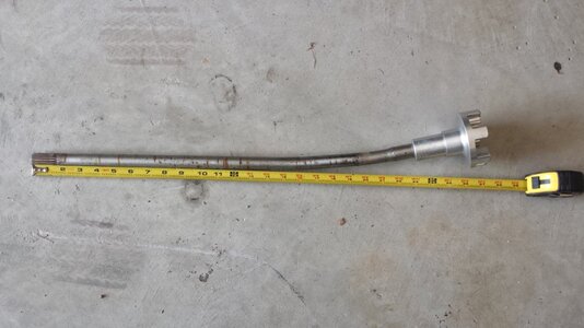

does anyone know what kind of drive shaft i need for my EME Q8 with a yami motor and kawi pump? i bent mine last weekend trying backflips. its bent to far to straighten. i was thinking i need one from a 750 ZXI but i cant remember.
Here is a pic of my drive shaft. Does anyone have a 650 sx or 750 zxi drive shaft laying around that they could measure? It's looking to me like the zxi is the one I need. Might be because of this long coupler??
Looks like an extended coupler on there. I wish I could help pin point the driveshaft it is, I went through the same thing over the winter. A bit of advice though, be sure you make note of the taper that sits inside the bearing carrier and rides on the bearing and seals. The location of that taper tends to change between models. (My driveshaft was welded and machined to extend that surface - I had to get a custom Skat driveshaft) Here is a thread that helped me a little bit:

It is a 650sx shaft if it has 18mm threads. 750sx shaft if it has 20mm threads. The "longer coupler" is just a threaded adapter.
There's pics of the adapters on my build thread.

PS - if you need a 650sx shaft, I have several of them in the back of the shop... just pay shipping and it's yours.
550/440 I'll probably take you up on that offer. I have several at my parents house but it cost me $30 just to drive there. I'll shoot you a PM. Thanks alot everyone I really appreciate all the help.
