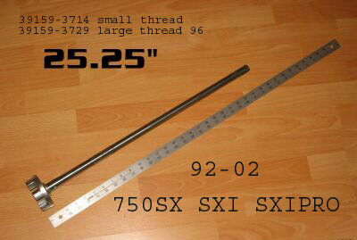

Are there any differences in length or anything else between the SX, SXI, or SXI Pro driveshafts? And how much shorter are they from the stock SXR driveshaft?

The SX and SXi are the same. I could be wrong but I believe that the SXi Pro's is a little longer (maybe 1") because they moved the engine foreward. I could be wrong though, I heard that a long time ago and never checked my skis.

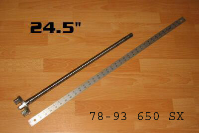

Just out of curiosity, what about the length of a 650sx driveshaft in comparions to any of the above?
going by memory, it seems like the 650SX, and teh 750SX ones are the same length. the difference is where the bearing bearing surface is. where the shaft goes through the bulkhead.
