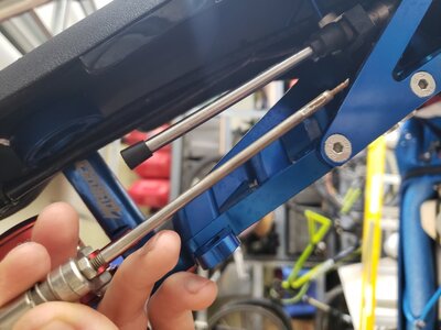

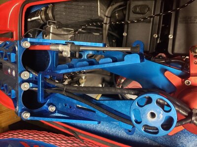

Do You think this is from age, saltwater exposure, or incorrect installation? Steering hits bump stock in both directions so I'm suspecting corrosion.2019-05-03 14.55.58.jpg2019-05-03 14.56.21.jpg
it could have been incorrect adjustment over time, pulling it past where it should be pulled, creating excess tension.
that looks to be the cable with the blue cover. not sure if that one is the solid wire in there or the multi strands.
I know red housings have multi strands and those are better.
I've broke many a solid wire cable. mostly on my sxr.
bottom line is replace it and make sure its adjusted correctly.
try not to play the pump wash your buddy game, whipping the bars back and forth. that's a recipe for disaster.
I always use extra nuts to cover any exposed threads at the adjuster. that's a weak spot that tends to kink there.
Check the angle on cable there also. I had a cable fail like that with the retainer bracket pointed the same way yours is. I spun the little bracket on the rrp pole around 180 degrees and it lessened the angle it held the cable at in relation to where it mounted on the ball pivot on the turn plate. I think corrosion plays a bigger part here but any less stress you can put on the cable right there can't hurt. If you pull the chin pad and look down at it from the top you'll see what I'm talking about.
My thoughts are the jam nut wasn't tight. Those slip collar quick connects on the oem cable are not exactly a precision fit to the cable threads. The jam nut applies the tension needed against what thread pitch contact there is in there, with it loose the cable will strip itself out of the slip collar. I'm with Buzzard on adding extra nuts behind the jam nut to give the tread some added diameter and support.
If you get a cable from push pull in chico, it will be cheaper than oem, much better quality, and when issues like this happen, it can be rebuilt back to new for 30 or 40 dollars.
